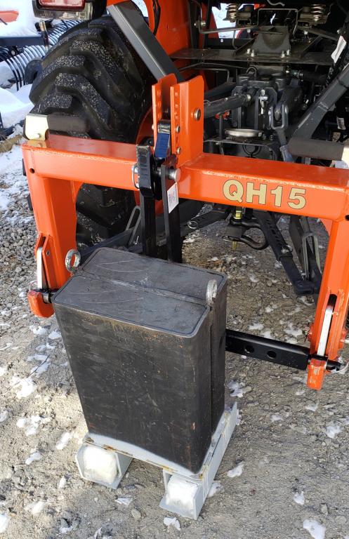

A "Close & Heavy" design.
About 750Lbs 8"x12"x20" full of lead. Not the most dense I could find but it was way cheaper than gold!

I have a Kubota ballast box and thought it was a PITA on my 2380. It served basically only one function, and wasn't easily quick hitch compatible, I'd fill it with dirt, rocks, sand, or similar then it was a pain to empty. I recently switched to Heavy Hitch with eight forty pound suitcase weights. It cost more but I am able to use it for various other things. Hauling my trash cans, towing my jet ski, skidding logs (I use a chain from the draw bar mount to prevent it from rising any further than I want it), and it easily works with my QH15. I wish the dealer I bought my tractor from knew about them as it would've saved me money overall.

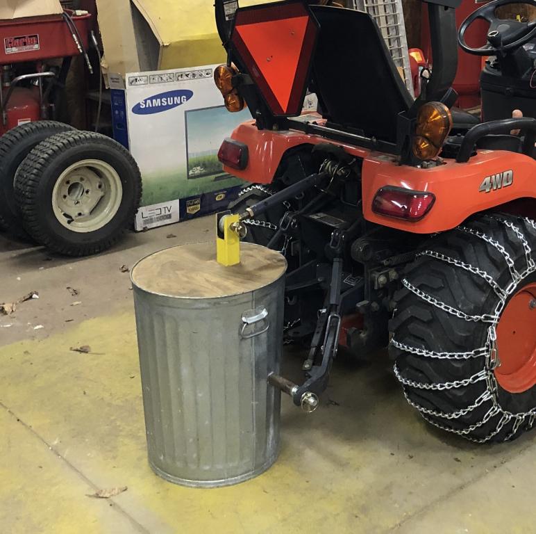

11,380
4,890
One option may be a 3 piece 'carryall' weight box. I built a 'carryall' that uses removable forklift forks. When I need ballast, I backup to a 'skid of weight',lift and go. I drop it off when done. Use the forks to move 'skids of stuff'. Remove the forks and the use the 2" receiver to tow 'things' here and there. While it's more pieces to handle, it's a lot easier for me ,old body can't fo what it used to...
