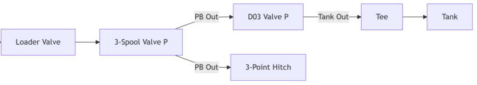

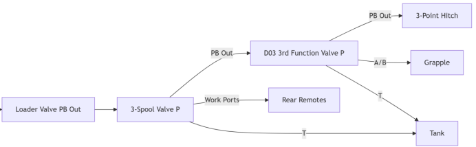

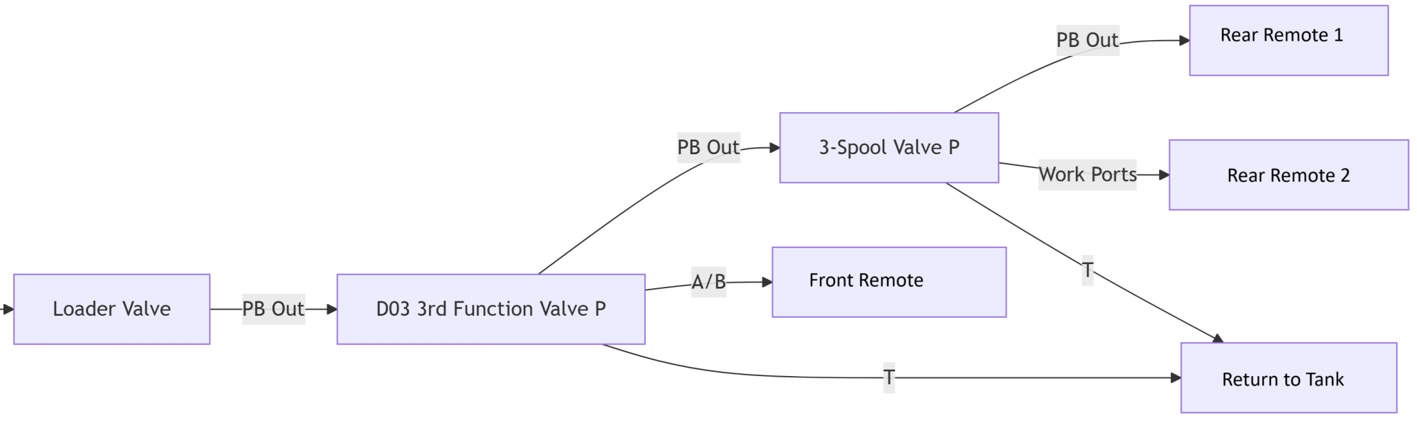

A D03 tandem center directional control valve with 12VDC solenoid, switch of your choosing, and an open center subplate for the 3rd function.
A 3 spool open center directional control valve with power beyond port and your choice of spool action(s) for the remotes
Hoses, fittings, 1/4" couplers, and brackets to mount and plumb the valves. Do you know how the circuit is plumbed into the tractor hydraulics?
