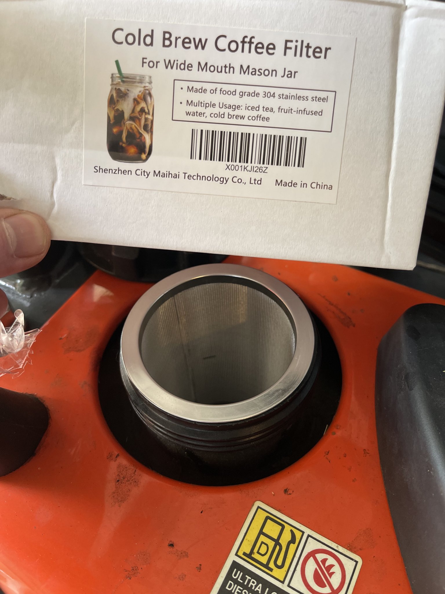

After I got a leaf in my tank I started researching fuel tank strainers. I saw some guys DIY something and some guys have the UTAH bio-diesel build them one. I believe I found something easy and cheap. It is a wide-mouth mason jar cold brew strainer off of Amazon. It not only fits perfect and it was only $13. This should keep any crap from floating in, like that darn leaf.

Yes, this is it! Fit's like Kubota made it!
Great find! I may buy two, one for my BX2200 and one for my son in law's BX23S.
The ONLY thing that is holding me back, is that the fuel gage from day one never worked right on my BX. Not a problem, as I just look in when I think it is time, and add fuel when I see the level is low enough to make it worth lifting the fuel can.
I am thinking with this strainer I might have to keep removing it to see fuel level. Not sure how much fuel the top 5 inches of the tank holds...

I thought this was a great idea and it is, so I ordered one. Arrived today. Won't fit in my BX2380 fuel tank. There is a ridge about 2" down in the tank and this won't fit past that ridge. YMMV
