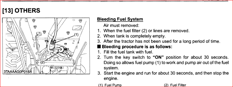

Should just have to put key in the on position and it will bleed itself!
10,745
2,551
You do not need to "bleed" the system via a bolt/nut !!! - the BX will bleed itself !
once you finish the new install - turn key as you mentioned - listen carefully to the pump!!! it will tell the story..... the clicking and the noise as fluid is pushed out will change in the pitch of the small fuel pump.
Hold on for about 30 seconds - you will not hurt anything - this will pump fuel throughout and push all the air back into the tank via the bypass at the injection pump.

I guess I should refer to my manual more before I refer to youtube... Thanks Lever and Hokie - that will make my next filter change easier 👍
