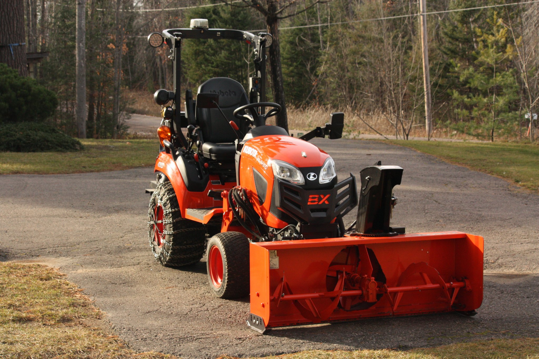

I have the K-connect system and front mount BX 2816 snowblower, goes great, no complaints.

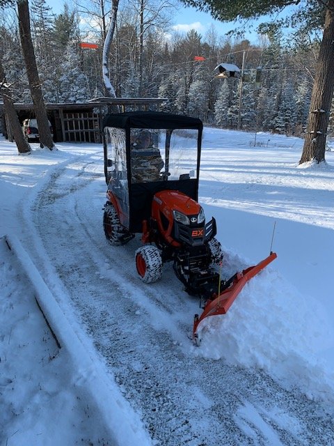

I have both the 54" blower and 60'" power angle plow on my BX 2680. The plow is a BX 2812A. Ideal set up to do exactly the same as you are looking to do.

So watching some videos, looking at the plows connection, it looks to be the plow has it's own built in connect system with a hydro cylinder that connects to the BX frame?
So I would be taking off my blower AND K-connect mount to mount this plow?
This makes sense to me now as the K-connect for the blower is a mid-pto driven system.
