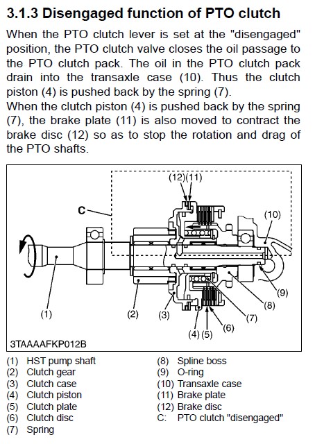

I wouldn't think the brake plate is the problem. If it was locked it wouldn't have allowed the PTO shaft to rotate in the first place.
Was it the first time the Trimax 150 mower attachment was ever used on that particular tractor? If so was the PTO shaft sized correctly? I'm thinking the shaft locked up and destroyed the housing.
I'm with you. Likely the PTO shaft was too long and bottomed out when the mower was set down. I wouldn't think that brake would have enough stopping power to hurt itself.

Very very unlikely the PTO brake caused an issue, they just don't fail like that.
#1 PTO shaft length issue
