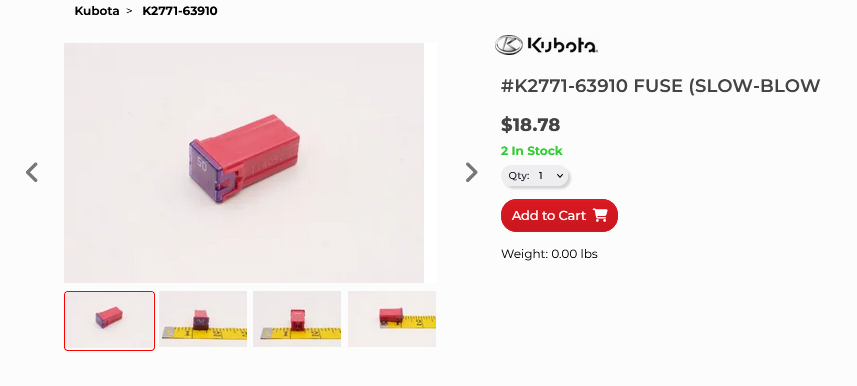

Having fuel delivery issues. Fuel pump is not operating. Haven’t yet checked if power is at plug, but it was recently replaced so it may not be the issue. The fuses under the dash are good. But found the slow blow fuse shows a short. Does anyone know where I can find the part number for the fuse? Attached is the wiring diagram found online.

See pic below for the fuse you are asking about, but..., If this fuse is blown, then the key switch should be completely dead, no dash, lights, or anything else, is that the problem you have or just the fuel pump not running?

There is nothing proprietary about fuses. They are available at most auto supply stores. Some are not inexpensive; however, when you need one, you have no choice. I have a friend who works at an auto salvage yard, and he has had to buy fuses, because that is one of the first things that the parts scavengers pull out of a car when it hits the yard.
