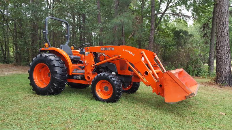

I purchased a used L4600 last year with 178 hours on it.
My checklist was simple.
- Owners manual and proof of purchase, maintenance records
- Checked fluids and air filter
- Quick look around zerks for grease
- Operated, 4wd, loader, 3pt all gears forward and reverse
- General condition and looked for signs of leaks.
Mine was kept in a barn but appeared to have never been washed, a bath did wanders.
All looked good, gave him a deposit and picked up 3 days later.
Good luck and the way a machine looks in my opinion can be a reflection of how it has been looked after and maintained.
The before and after pics below.

What what a difference in condition ^
It took me 3 days from sun up to sun down to change the look and service but I was pleased with the outcome.
I only added the pics so one could see that if is mechanically sound with a little elbow grease and time you can take a dirty mess and make it look nearly like new. Katie the Kubota just needed some TLC.
