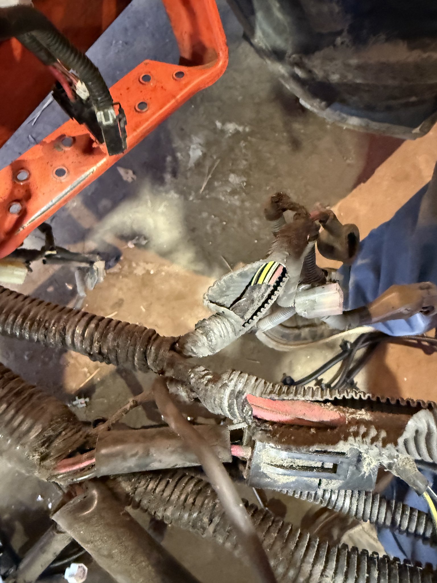

I the attached pics you can see some heat related wire damage but IMO not wide spread.

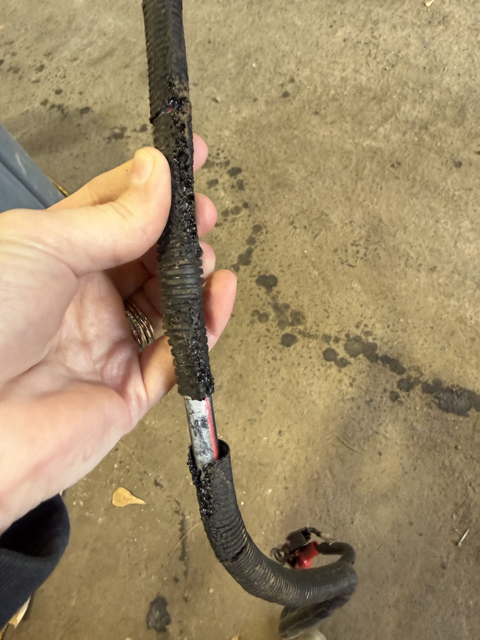

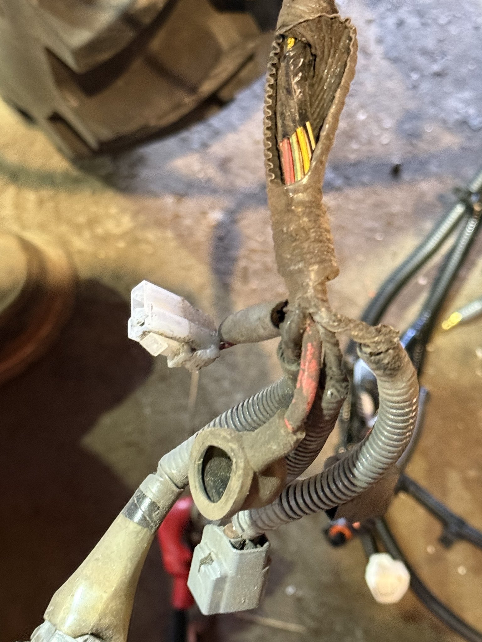

From a warranty point of view I can understand why the Kubota dealer wants to replace the whole wire harness; this probably only comes in one piece and is probably fairly time consuming to replace.
On your pictures I can only see damaged outer plastic slieving. On the wires inside I cannot see any damage to the insulation, but there are other parts where the inner wires are not visible and there must be damage due to the tractor not running any more.
If it would be my tractor I would remove the plastic slieving around the damaged area, inspect and repair any damaged wires and put slotted slieving around it. One obstacle here may be that CAN bus wires for example require a specific impedance (sometimes twisted pair) so repairing those has to be done a certain way.

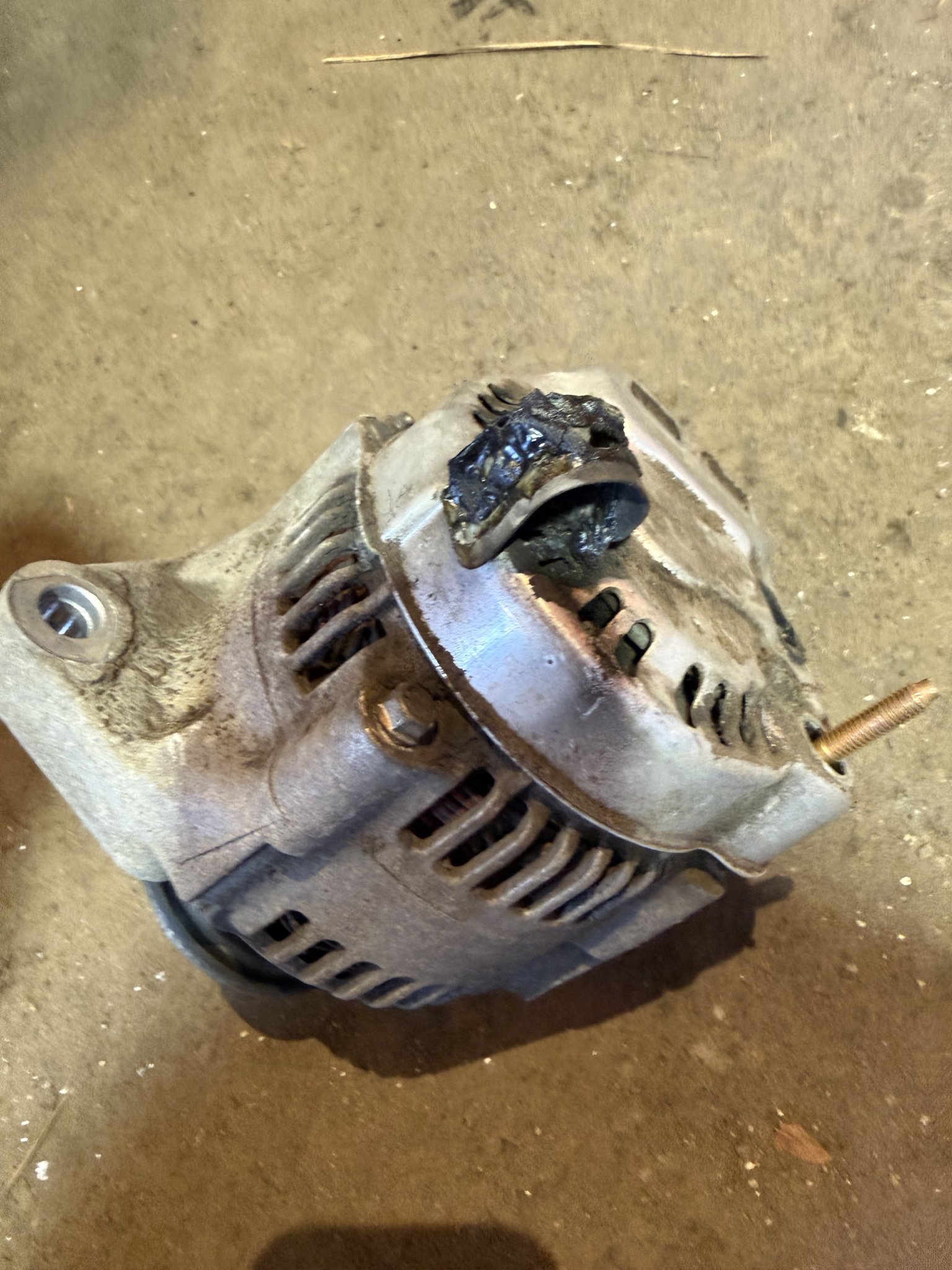

The connector of the alternator looks melted. Is that mounted fairly low down? An electrical fault there can easily start a fire.
Also my (garden) tractor has a fusable link, it is basically a piece of wire that acts as a last resort in a bad short. In my case this fusable link is located on the frame at the underside. Molten material from that link falling onto dried grass is certainly a possibility for a fire to start.

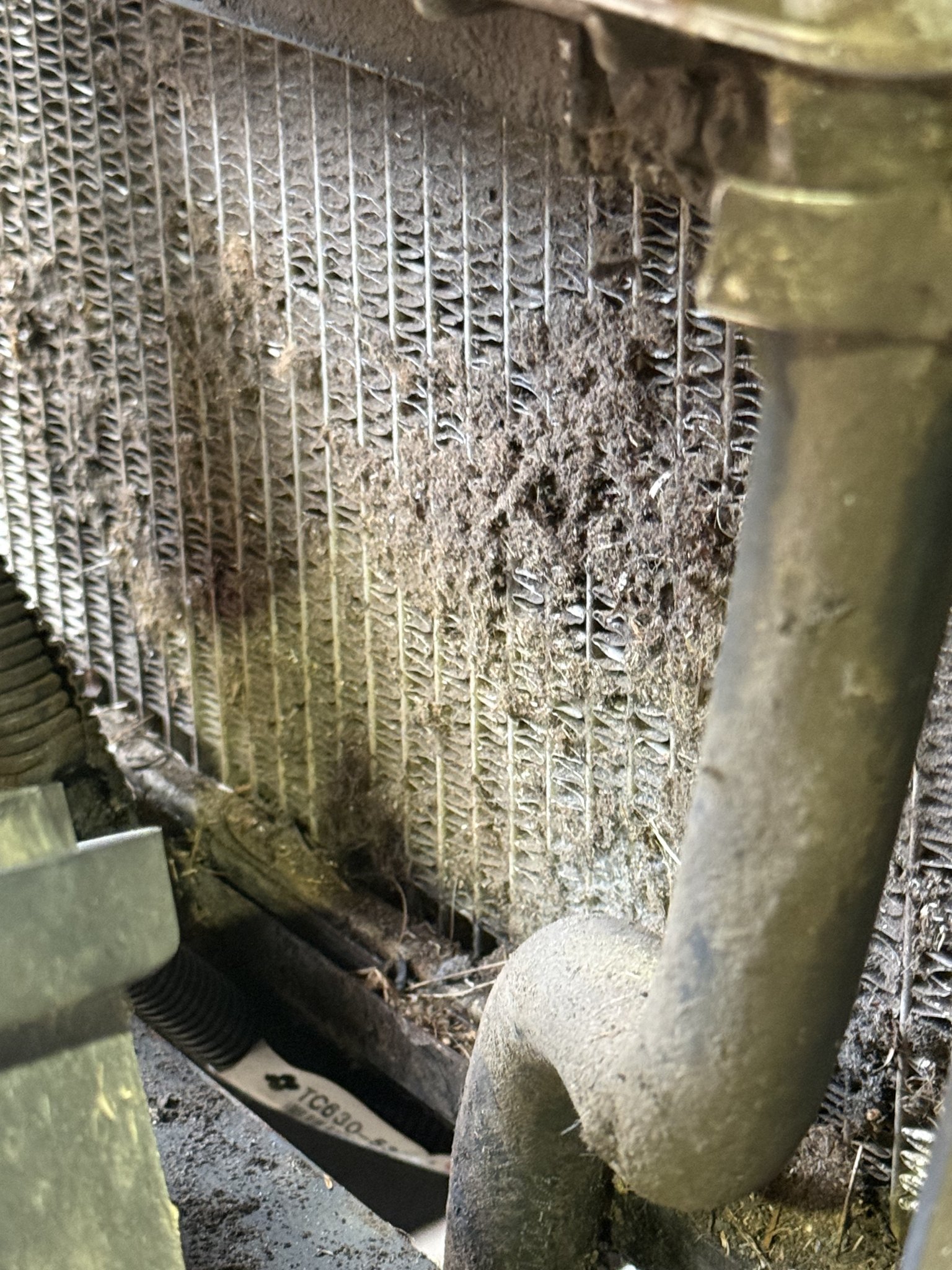

Is it possible the motor overheated causing the wiring damage and potentially sparking the fire ?
Looking at the clogged radiator I would say it was possible the engine overheated, but not speculating on if that caused the wiring damage.
If the engine did overheat to the extend of melting wires would it have not lost power and stopped before the wiring got damaged.
What seems even stranger is if the engine overheated, and finally quit due to melted wiring or just being way too hot, what caused the pto shaft to break two foot from the pto? Coincidence that both happed at the same time?
I would be more inclined to believe that the broken pto shaft caused the fire and ended up shutting down the engine due to wiring fire damage.

zooming into pic #1 it looks like the grass under the tractor burned and in doing so took out some of the low laying wires and alt. on the LHS of the engine compartment. Hoping it took out the fuse block of the 40/50a fuses near the rad overflow bottle thats low to the ground on the LHS and would stop the engine.
Hoping it took out the fuse block that sits near the overflow bottle leading to the tractor shutting down with rad hoses intact etc... If this is the case hoping the ecu should still be OK and the engine shut down w/o damage.
closer inspection and some better pic's of ecu and rest of engine compartment will yield much better opinions and thoughts.
Can you get better pic's of the engine on all sides and under the dash area? would be very usefull. The pic's very limited for good guesses some wider ones that we can zoom into would help of engine compartment and underside of tractor and above/below dash.
my first guess is if I didn't have insurance I would take on trying to repair it but more pics of larger areas will sure help
