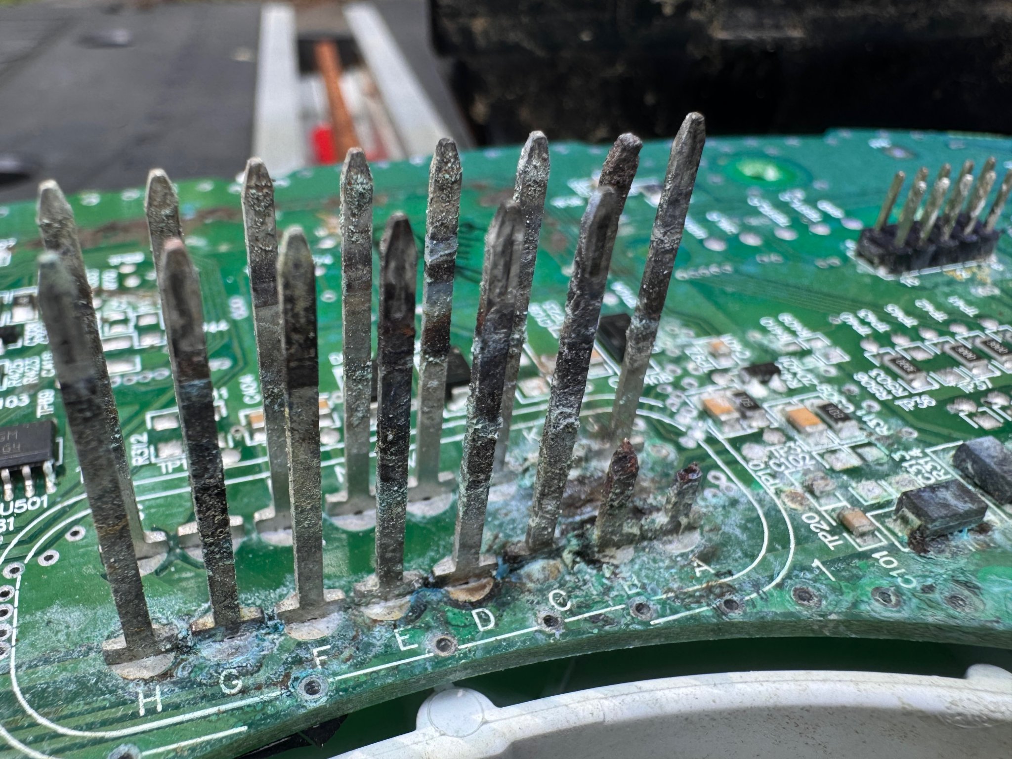

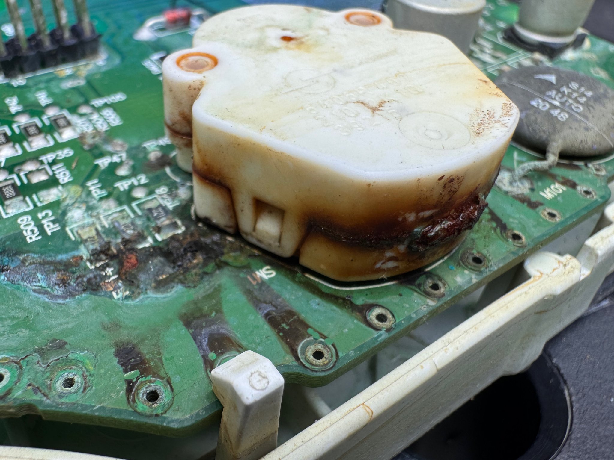

Here are a couple of pictures of the water damage in the gauge cluster.
You can see that some of the header pins are completely corroded away:

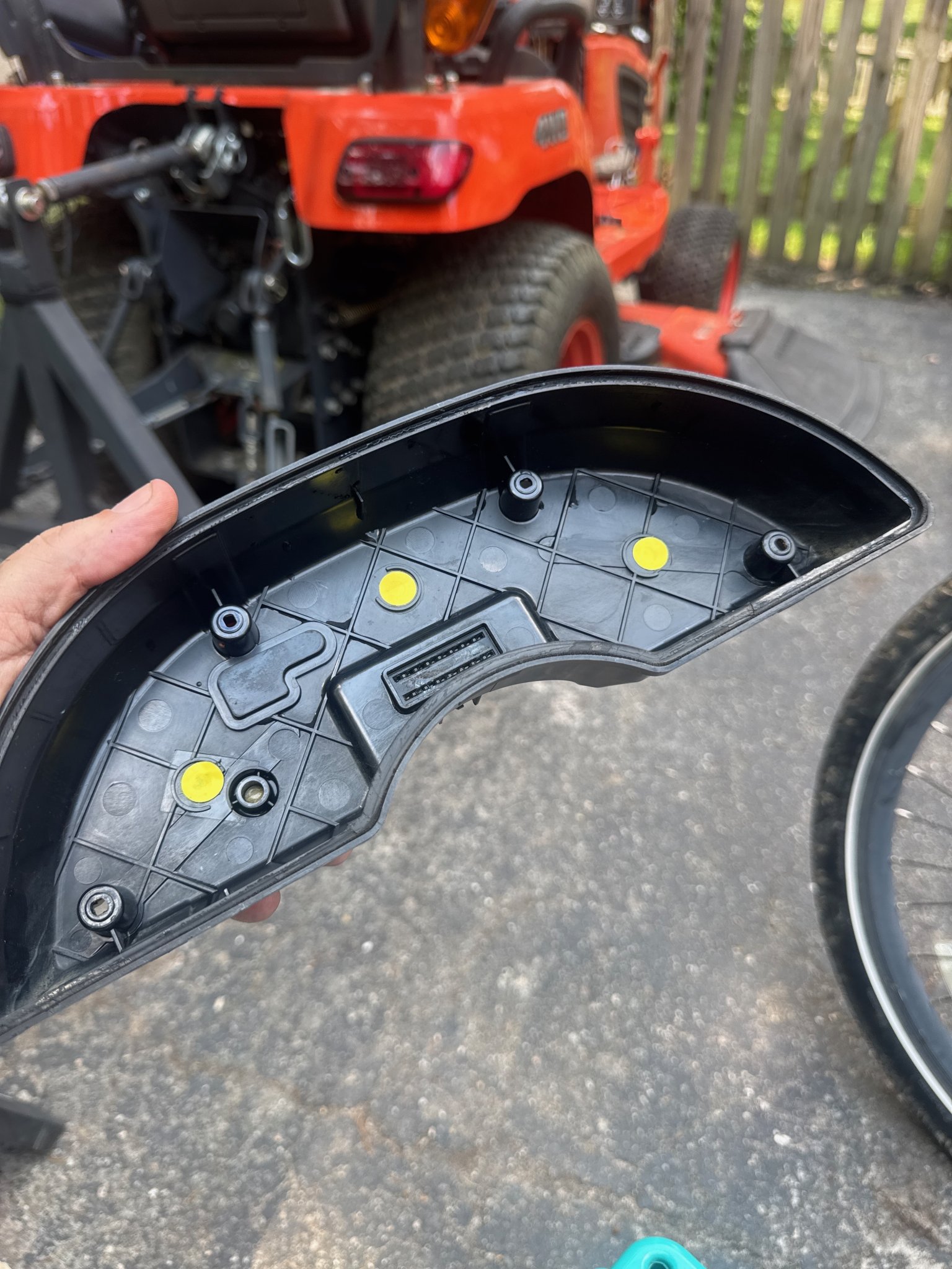

I am looking for a way to reuse the stock pan if possible.

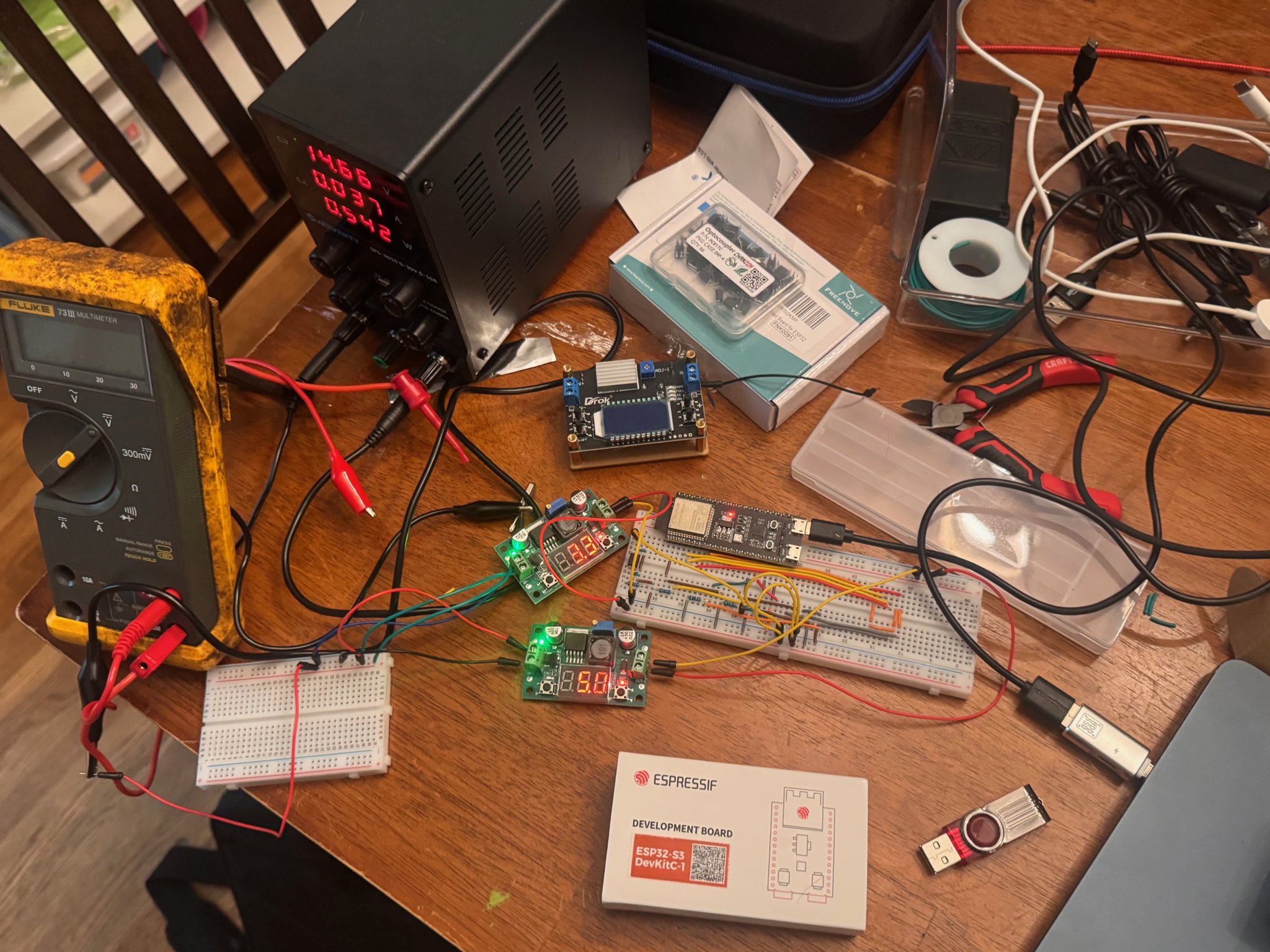

My "workshop"

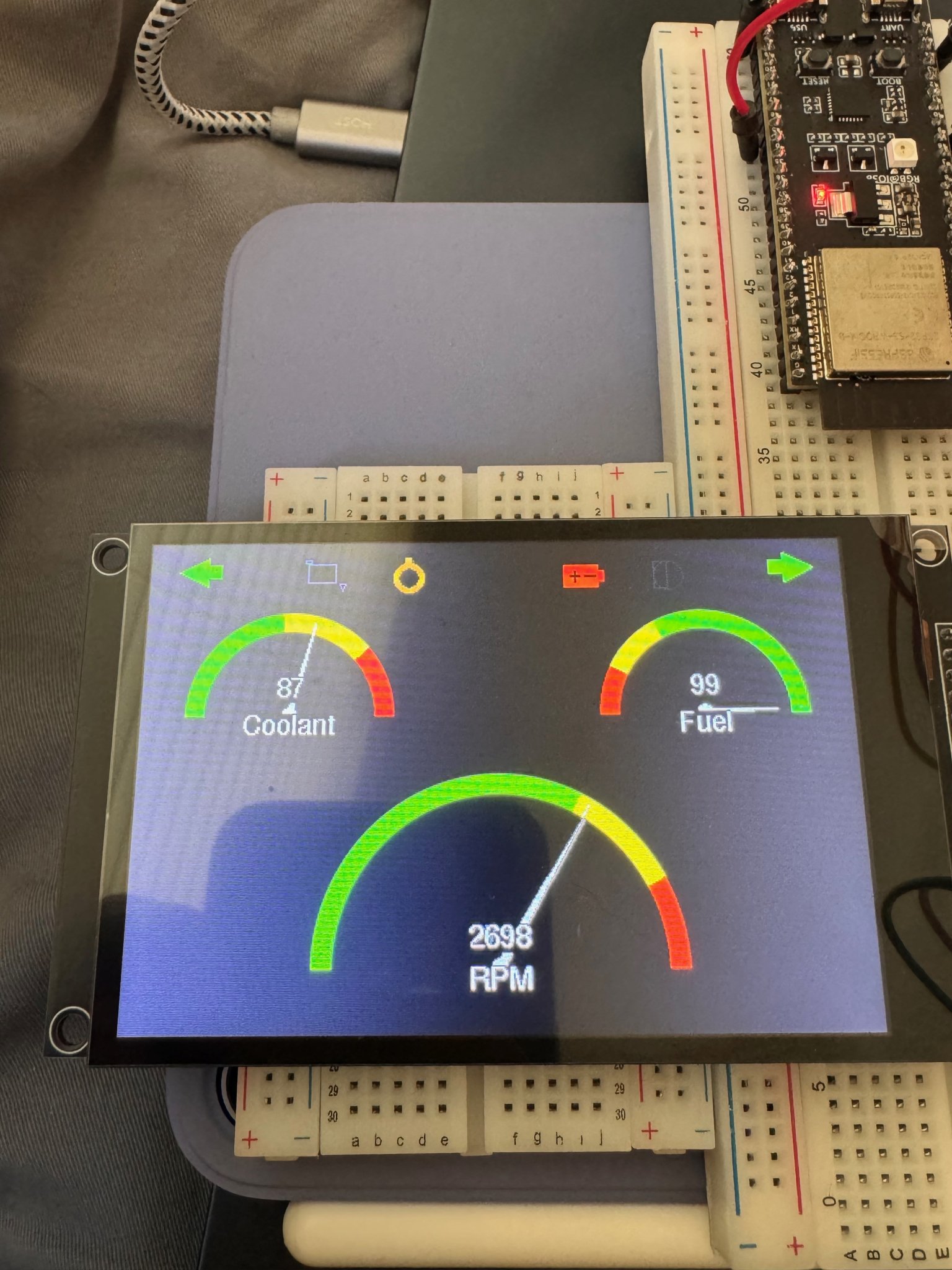

A prototype of the user interface:
My "workshop"
