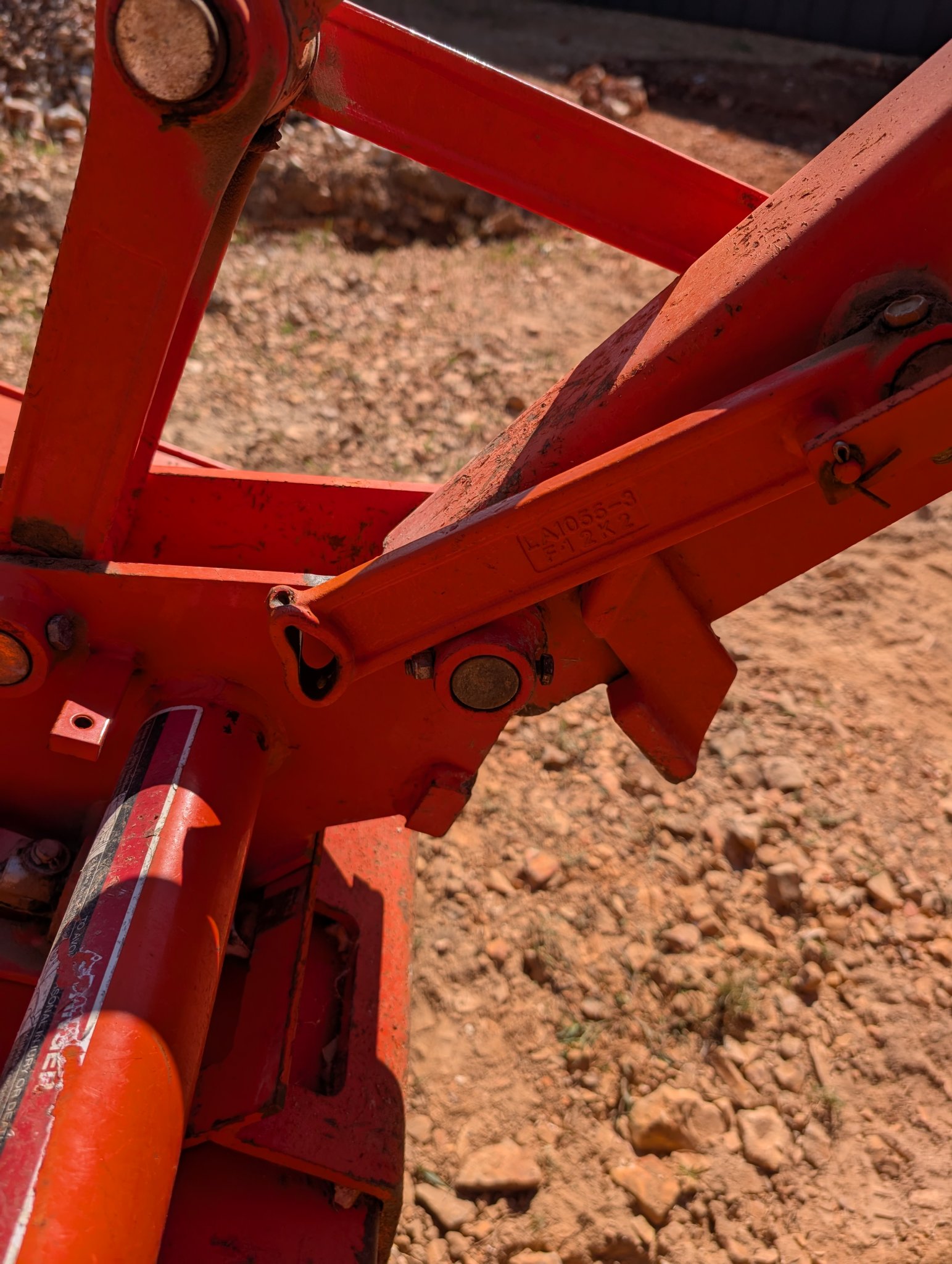

Hi all,
Was working with the leveler 2 minutes ago, all of a sudden it stopped moving. Got off and noticed the arm is all bent and loose.
I'm guessing I need to make that into a circle again, but what does it go around? That rectangular post in the photo?
Thanks all!

Son of a b. Just realized arm holds the hydraulic, well that has to be perfectly round so I'm guessing I need a new one.

Thats what I would guess. Bolt and nut are no where to be found.
Any ideas where to get this cheaper then the Stealer?

Just a reminder that those keeper bolts need a nylock nut and aren't supposed to be tightened. They need to be able to move freely. If they are tightened they will break for sure.

keeper bolts arent anything special.
the pins themselves are.
ive sheered several keepers on backhoe pins. i just replace them with whatever is handy.
it helps to inspect before and after use for broken missing things
