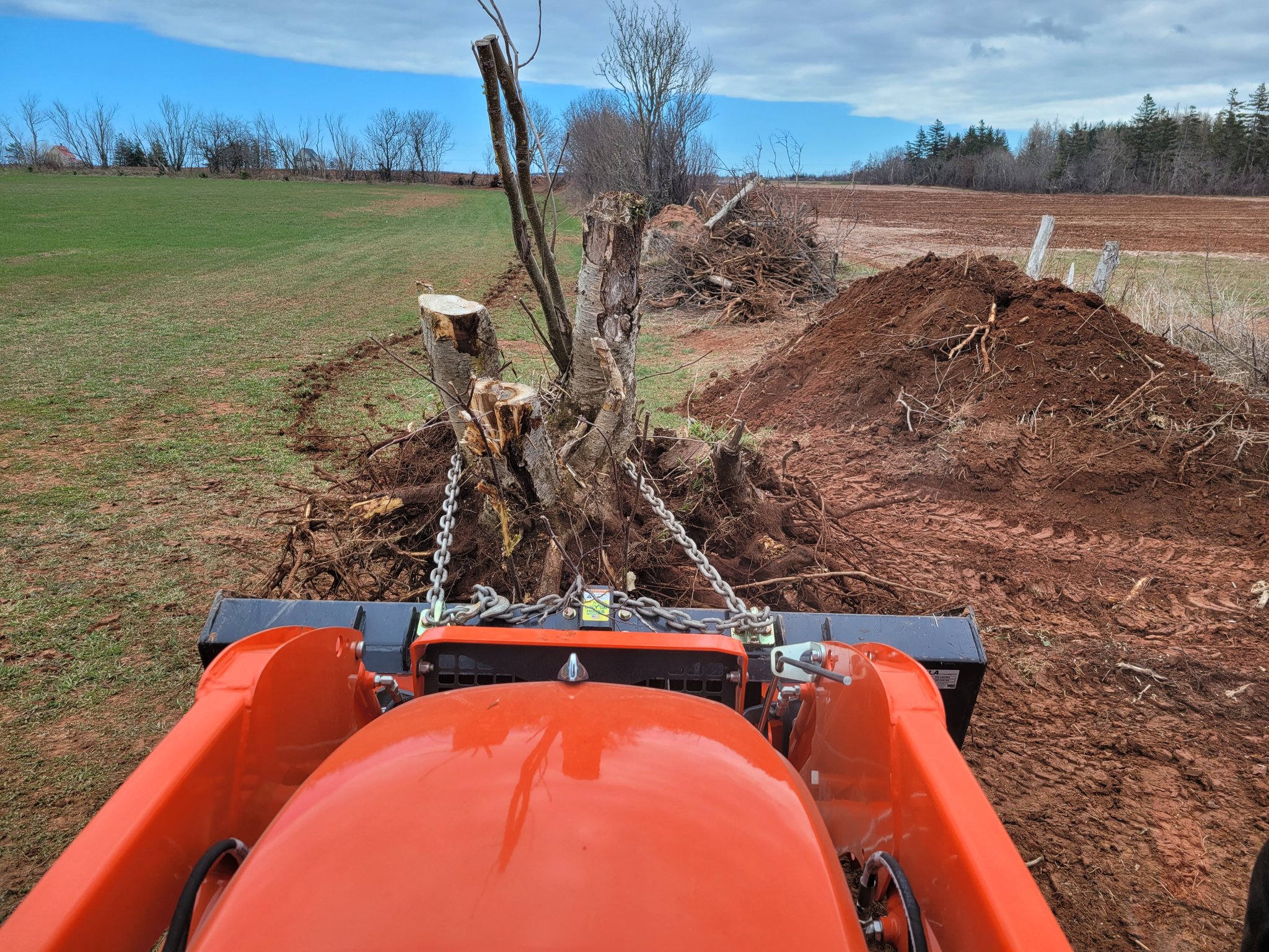

Yes both pics are from your site. Im trying to determine where to put the hooks. I anticipate having to pull straight up and was concerned that curling the bucket under, as in the first pic, would stress the cylinder seals too much under heavy weight.

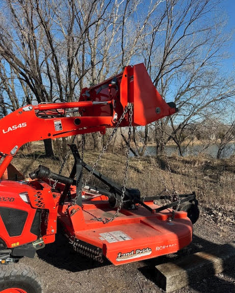

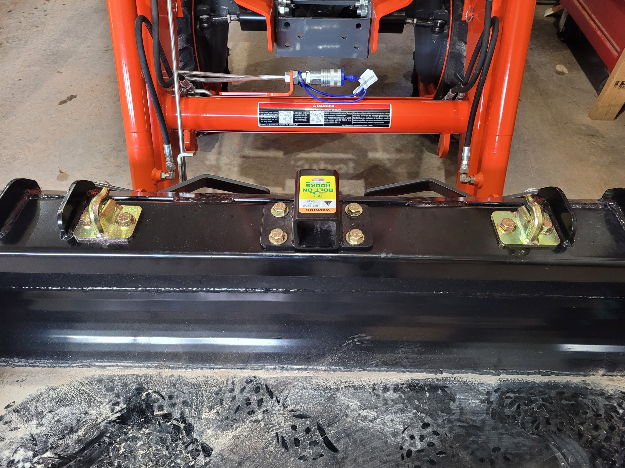

I use the hooks I posted, my little tractor cannot lift more than the top lip of the bucket can support. For larger tractors the lift capacity vs the strength of the bucket lip could be an issue. I purchased your hooks for my brother-in-law this year, his tractor is much larger and these work very well on his machine.
I never pull from the bucket, I was taught that when I was young. Bad leverage and likely to break something.

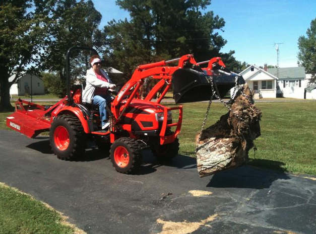

That tractor's going to get scratched
Yikes! Before building forks to move things like that, I rigged stuff to minimize chances of scraping and denting the innocent. Below was handy for keeping a low profile for reaching and/or setting the RFM on a shelf.
