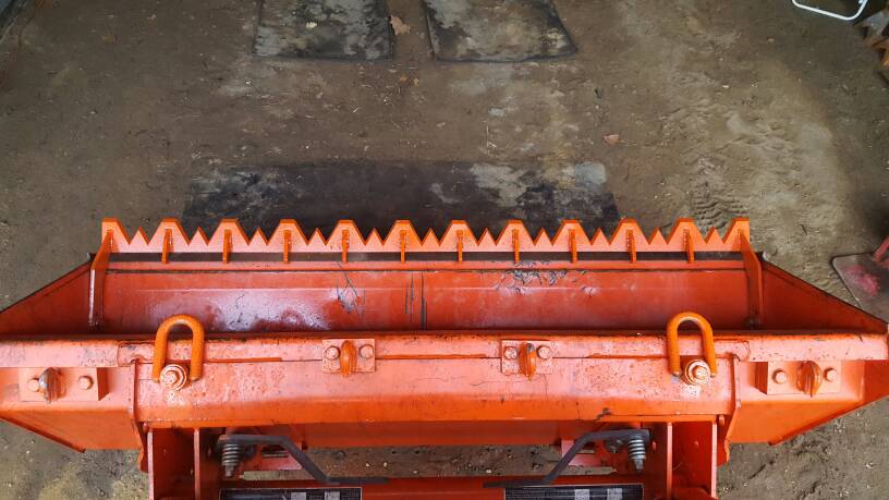

I think I’m deciding to go weld on. I really wanted to like the bolt on, but after taking a look at the bucket again tonight after my Amazon bolt ons showed up, I think the backing plate will be in the way of the quick attach connector if I put them inline with the loader cylinders.
I do think I can easily weld the hooks on. I was trying to avoid matching the paint or going with a painted hook since the paint will wear off eventually.
For those of you who have welded on, would you do it again?
I’ve read a few comments that suggested a center hook can result in a bent bucket. They didn’t specifically call out the L2501 bucket. A couple of related questions, did you weld on a hook in the center or add a shackle holder to the inside? Would inside be less likely to bend the bucket on the inside or top of the bucket or should I not worry about bending the bucket?
Btw, I planned to only use the bucket hooks inline with the loader cylinders, but I thought I’d ask about a center hook/shackle clevis. I’ll have to round up hooks in any case. I just need to know if I should be looking for 2 or 3.
Thanks in advance. Any other related comments are appreciated.

Two grade 8 bolts on 1/2" plates bolted through with large flat washers and nylon locking nuts ...........
beat the weld around on the thin bucket any day! :LOL:
then again - my BX aint gonna break a welded bucket nor break the bolts either........
the arguing points are this ............ a weld is weld - either it is good weld or bubble gum imitating a weld, that is not the point...... the thickness OF THE BUCKET at the weld point....... to ME that is the weakest link.

I like having 3 hooks on bucket like 85 Hokie set up. It works well for all situations. This is on my B2650 which has a nice 1/4" plate on top to weld to. I think your bucket is the same set up. Weld on, and paint.

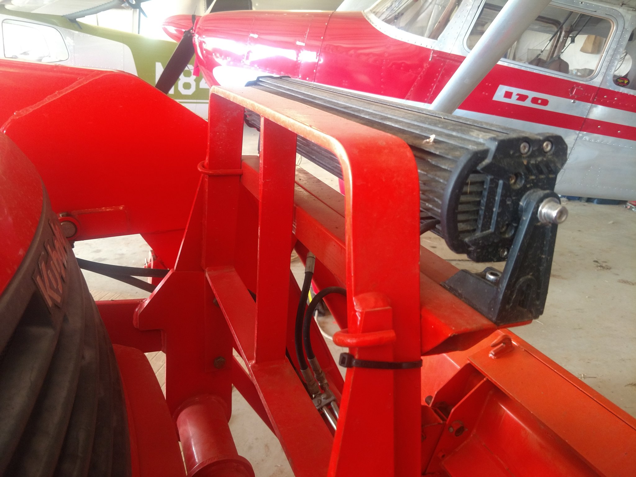

Measure and pick up a piece of steel to double-up the top of your bucket, and then weld the hooks onto the doubler.
My tractor is larger than yours... but my bucket is a “materials” bucket and not a construction bucket.... so it is a similar situation. So the solution (previous owner did this thankfully) was to lay a 36” X 6” X 1/2” slab of steel on top/behind the upper lip of the bucket and weld it down. This strengthens and prevents the bucket from bending or deforming at all. He then welded a large Clevis top-center onto that doubler.
I wanted Hooks... so I WELDED Hooks on top of that doubler also... in front of the cylinders. Complete satisfaction.
I don’t have a pic of it... except it can be seen in this one I took to demonstrate the LED Lightbar I installed on my grill. Look below/in-front of the lightbar and you can see the Left Hook welded/sitting on top of the 1/2” thick doubler. I doubt you need 1/2” thickness... 1/4” should do fine.
(BTW, rattlecan Rustoleum in Kubota Orange is a perfect match and touch-ups perfectly. Tractor Supply sells it)

I decided on 4 hooks and 2 shackles, like the versatility of the 4 hooks. I don't use the ones near the edges when pulling heavy things. In fact last night pulling a small tree that had fallen in the creek, the outside right hook was needed to get the log past a tree still standing.
Good luck and a bucket without hooks truly limits it's ability to help you work.

Geohorn, you must have a really big tractor! That hook looks so small! What size chain fits it? 1/4 inch? Looks great though, job well done...I think I used 3/8 inch grab hooks myself...
LOLOL... it’s the hooks sold by my Kubota dealer... they’re claimed to be 5/16 but they accept 3/8” chain. LOL... that pic is taken at an angle that makes it look small because the camera is focused on the LED Lightbar... However, yes, the tractor is Kubota’s large “Utility” model M4700 with a 72” bucket. ZOOM in on that hook and compare it to the steel plate upon which it’s welded... that plate is 1/2” thick... and compare that to the hook’s jaw. ;)
