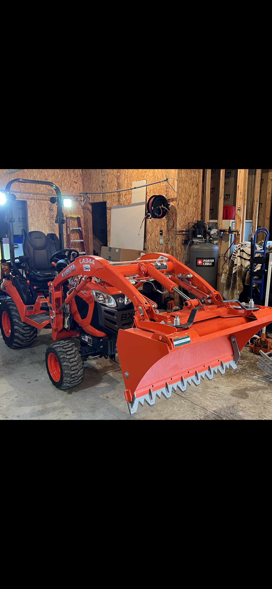

You had top soil delivered and are just spreading it you should be fine. Now if you are planning on digging or scraping fresh dirt/soil up, then it would come in handy to have a piranha tooth edge.

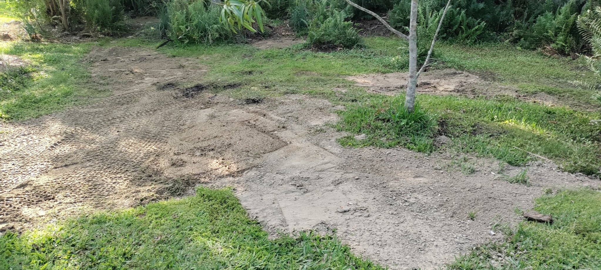

I spread some fill dirt with my bucket and regular edge by back dragging with the bucket almost leveled and in the float mode and I was very impressed with how well it worked. My only issue was that the fill dirt had some conch shells and when the edge would ride over them, it would leave a hump. I had to come back and remove the shell and finish with a rake by hand.

That looks good. Nice and smooth.. I will not have to worry about shells here as it's rocks and stone under the surface. Our town is Highland it should have been name Bedrock.
