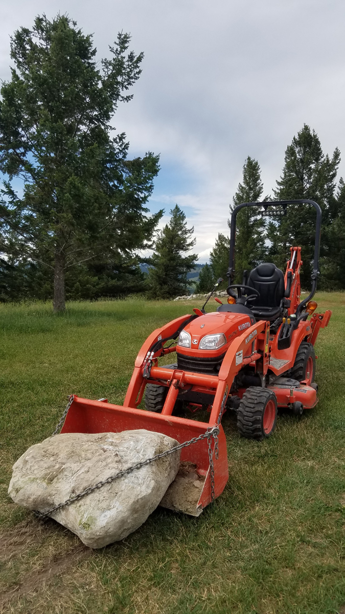

I owned a BX25TLB for five years. It came with the BT602 backhoe and I never had any such leaks. The only issue I had was that three hoses needed to be replace after three or four years. They had failed at the interface between the hose and the fitting.
My current tractors will pick up the rock shown in the second photo like it's a piece of popcorn, but all I could go was drag it with the BX25TLB.
