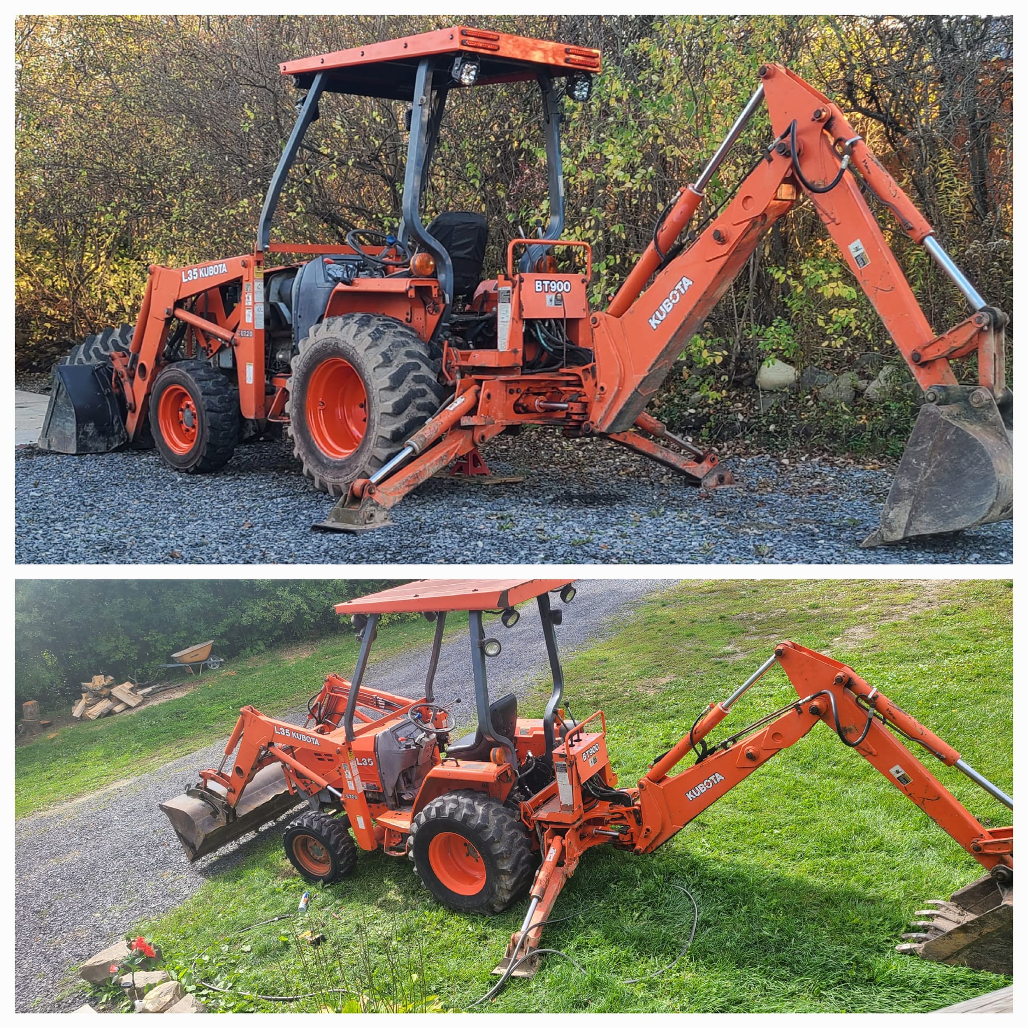

From the description....I'd think the cylinder is leaking( oil bypassing the ram seal )
hoping this will not be to expensive of a fix... what's the chances the actual gland is damaged? wasn't in the best of shape maintenance wise
, when I acquired the tractor a year or so ago. I have slowly been going through, rebuilding each cylinder. The swing cylinder is the only one that did not get better after rebuild... mine swings a tad better in 1 direction than the other., but it seems they both do not fully swing. drift is especially bad when trying to dump the dirt in either direction..

hoping this will not be to expensive of a fix... what's the chances the actual gland is damaged? wasn't in the best of shape maintenance wise View attachment 114886 , when I acquired the tractor a year or so ago. I have slowly been going through, rebuilding each cylinder. The swing cylinder is the only one that did not get better after rebuild... mine swings a tad better in 1 direction than the other., but it seems they both do not fully swing. drift is especially bad when trying to dump the dirt in either direction..
(top picture is current, and bottom is after a good bath & degrease)
That's a single acting cylinder. What's the problem with swing?
does not seem to swing full amount in either directions, drifts back to center somewhat. more so going left than going right. i just rebuilt them this summer along with my loader cylinders. did not fix the issue. This issue was happening before i rebuilt the cylinders. at this point im trying to find the time to swap lines around i suppose, try to see if its in the control valves. if so, i found a good rated hydraulic shop 2hrs away that can rebuild it. kits and parts are discontinued.
