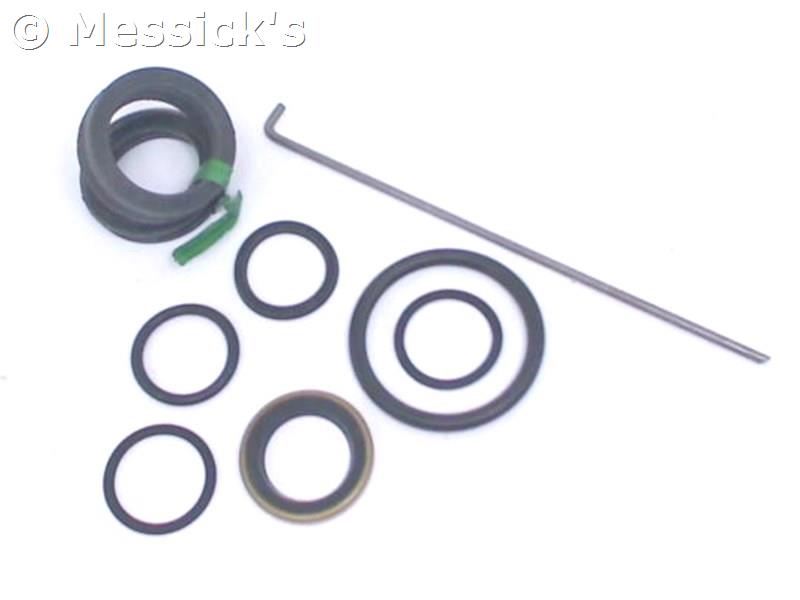

I have the same tractor and loader. I had to reseal one of my curl cylinders and found the receipt. Part number 70050-00299, about $40. My manual says the lift cylinder kit is different, there is a hand written number of 70050-00301 on it. Can't verify that one though as I have not had to do those myself yet.

I found the part numbers and parts from Lashley tractor in Ohio. The lift cylinder is part number 70050-00301 ($49.99 ea) and the bucket cylinder is part number 70050-00299 ( $24.35 ea) with free shipping. now that is a much better deal. I figured I would post this info in case someone else needed the same parts.

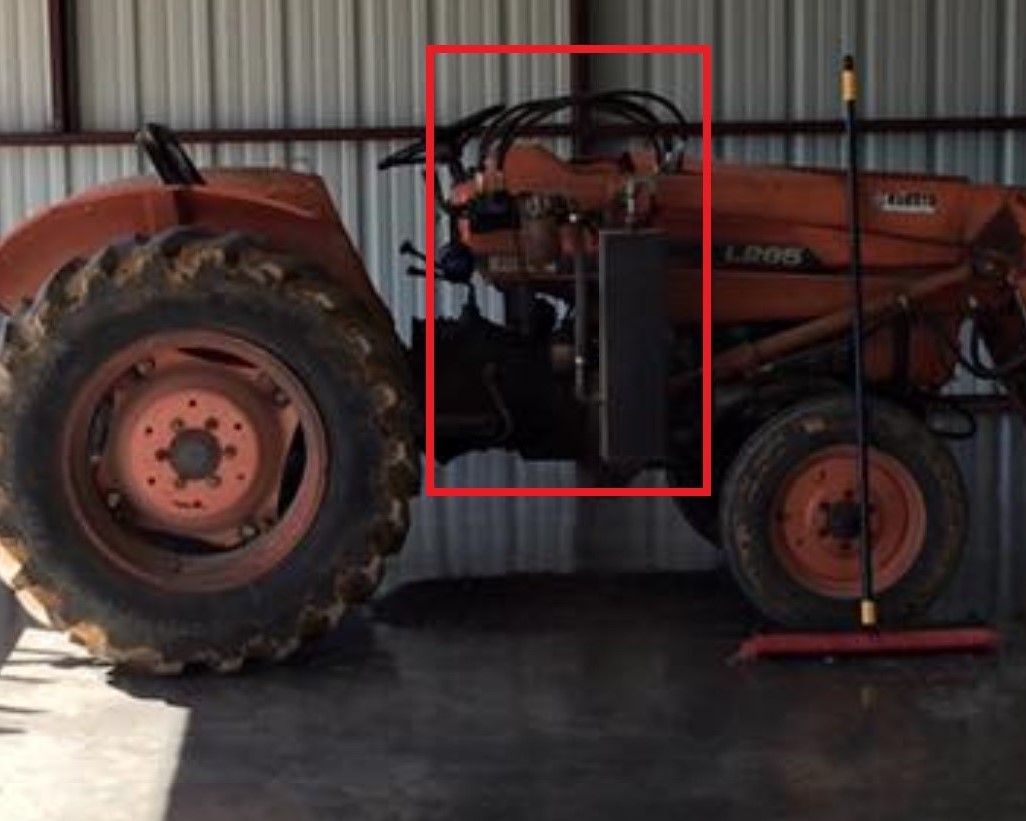

Also late to the party. I have an L285 and am looking for the L1200 loader for it but am curious. Where does the hydraulics hook up since it doesn't have remotes?
shootem604
Apr 23, 2018
875
British Columbia
It can tap into the hydraulic block under the seat - you will need a different block cover. Some were also run by a separate pump off the front of the engine, sometimes with a separate reservoir.

I got a seal kit from my local Kubota dealer and just finished the repacking of both front cylinders. VERY EASY JOB with the 1200 FEL manual and a little thought.
BUT FYI, the kit has a new designed "o-ring" for the pushrod compared to the diagram. The old diagram has a backing ring and traditional o-ring but the new one has a "square" o-ring/seal. I reinserted the backing ring because the new design did not fill the space. There are no instructions as to the direction of installation of the new design so had to wing it and in fact I might have done them in opposite directions to see if one was right (or wrong) Neither leak as of today and hope that continues.
Will get second set for future use and a set for the lift cylinders too... will call my dealer to see about that part number tomorrow...

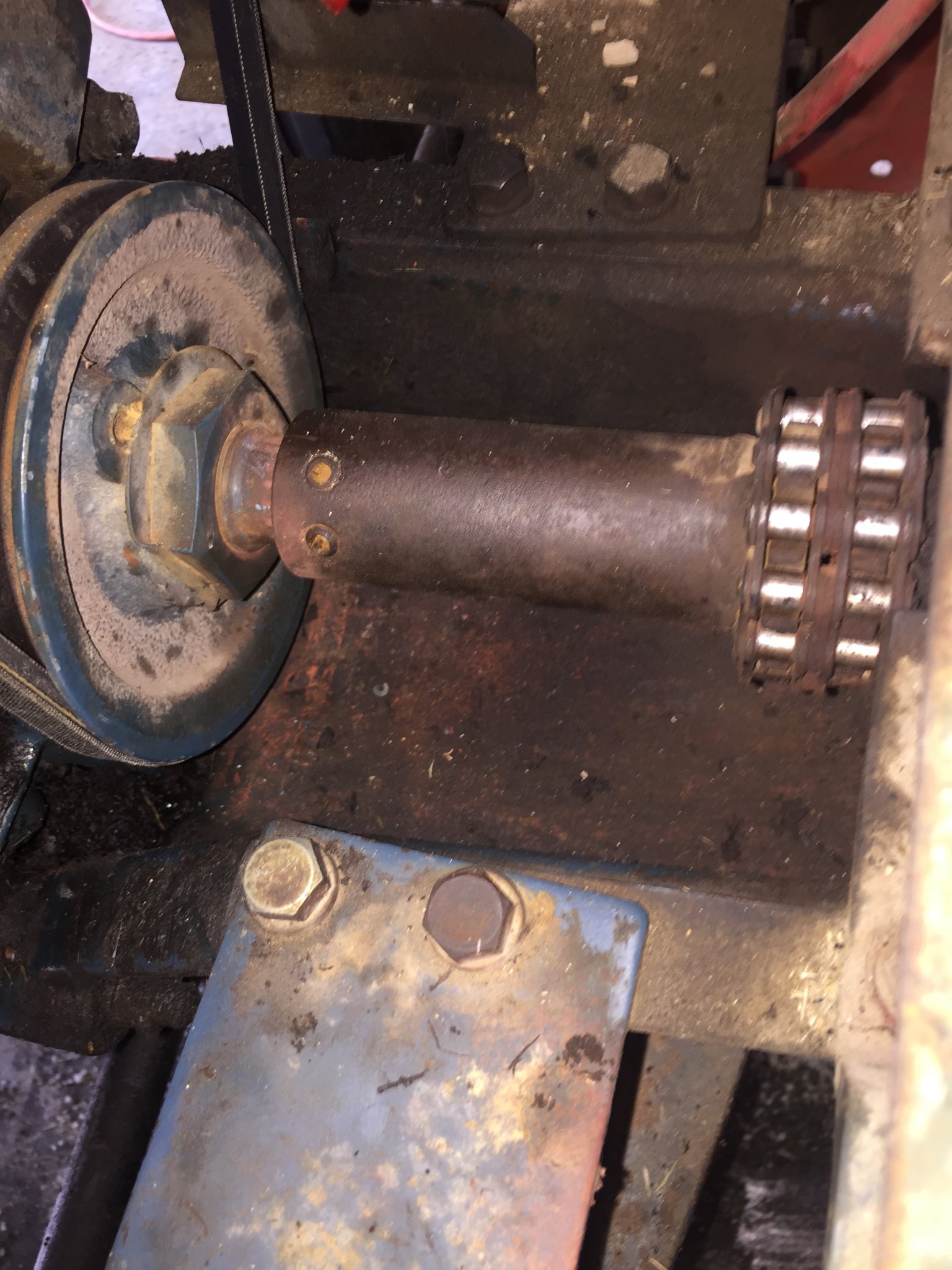

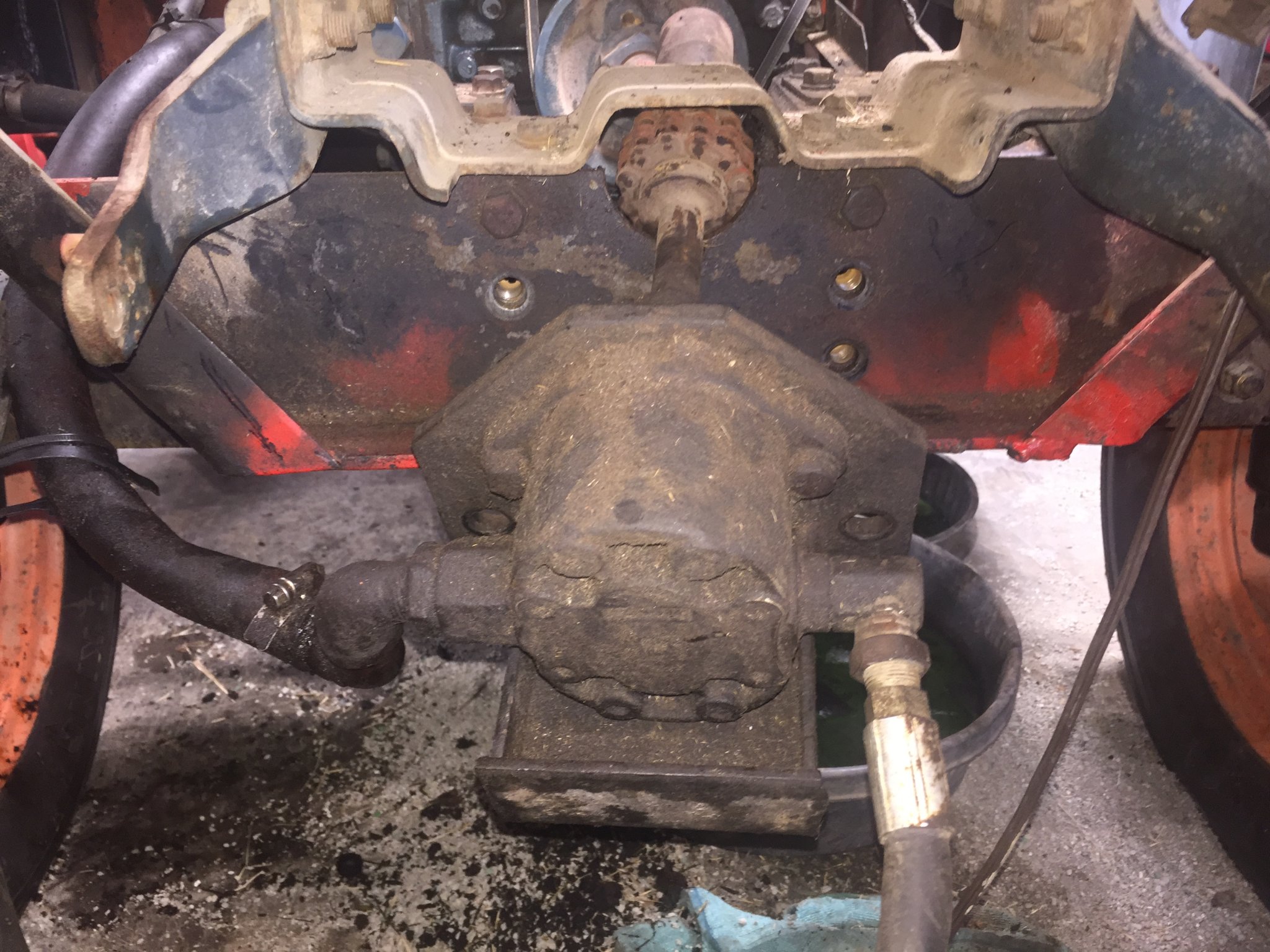

My Hyd pump is mounted (four bolts) in front of the front axle and driven by the crank shaft via an extension shaft that runs under the radiator and battery. The reservoir is side mounted and holds about 5 gallons. The lift and bucket control valve is located just above the reservoir.
