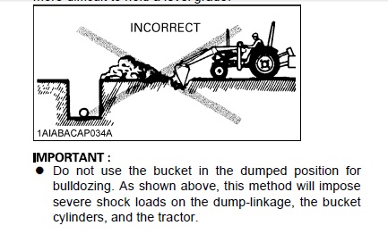

A close read of most Kubota loader manuals advises against pushing with the bucket tipped forward as the linkage which allows the bucket to curl far back to hold a lot also works to put excessive forces on the cylinders.
The situation is much worse using forks as many forum members have learned the hard way..
The following is not your from your loader's manual but most read the same.
Spend a couple of minutes watching this Messicks video explaining how you can put severe hydraulic pressures back into your tractor by the way you operate it.
Video
The $600 price looks like the complete cylinder. Taxes and shipping extra depending upon where you order it.
