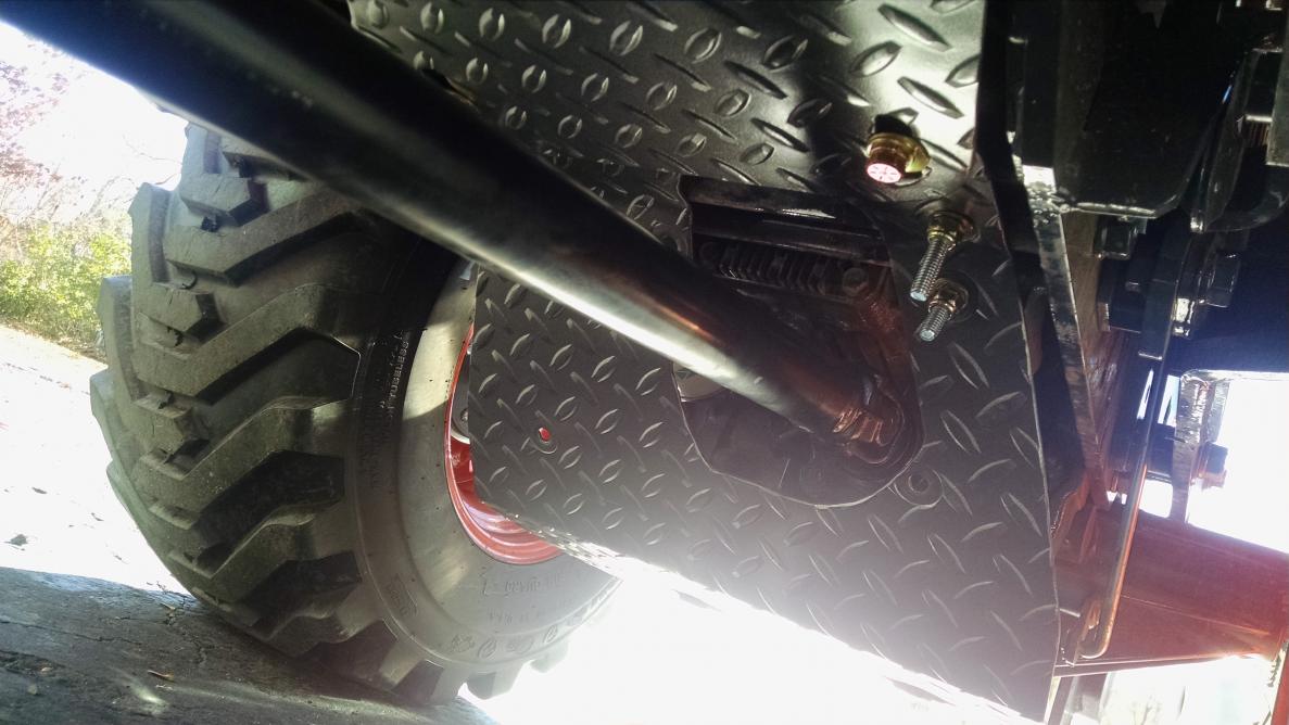

after breaking 2 fans I purchased the Bro Tek skid plate. I was also concerned about overheating. The service manager at the dealership wouldn't comment but my salesman-who used to be the service manager-said he would not hesitate about putting one on. Bro Tek was great to deal with and the plate was pretty easy to install. It is easier with 2 people so one can hold the plate up while the other is bolting it on. I installed it and used the tractor for about 4 years before trading it in on a B-no problems with it overheating. I'm so surprised that Kubota hasn't redesigned the fan or made it easier to replace.

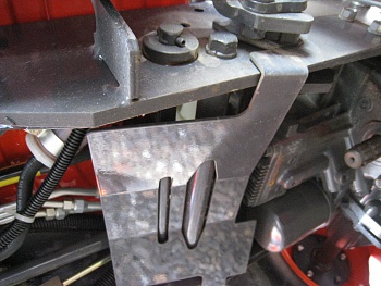

Kubota did place a smalllll shield on it in the 2013 year of the BX - it looks like it could protect the fan, but I too have some armor under mine.

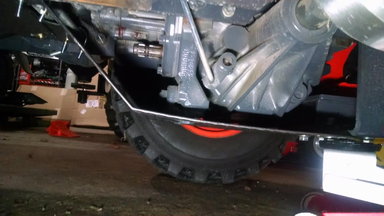

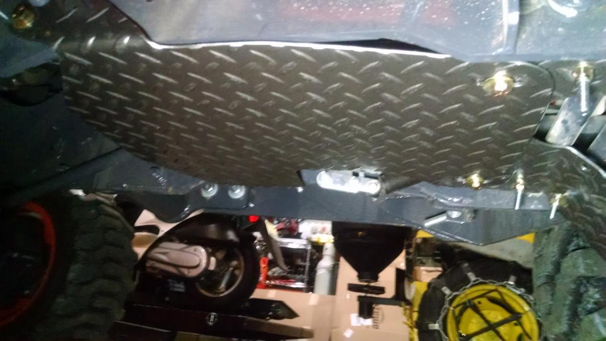

Bro tec for me - because they had a plate you can remove (for air flo I guess if you wanted but for me to hook up a PTO shaft (snowblower)
Bought the front plate also. I have no worries of overheating. They don't seal the bottom air tight..... Again you could remove the pto plate for more air flo if you wanted.
I used a floow jack to hold my back plate up - in case you dont have another person handy at 11pm when you might be working on your tractor :)
