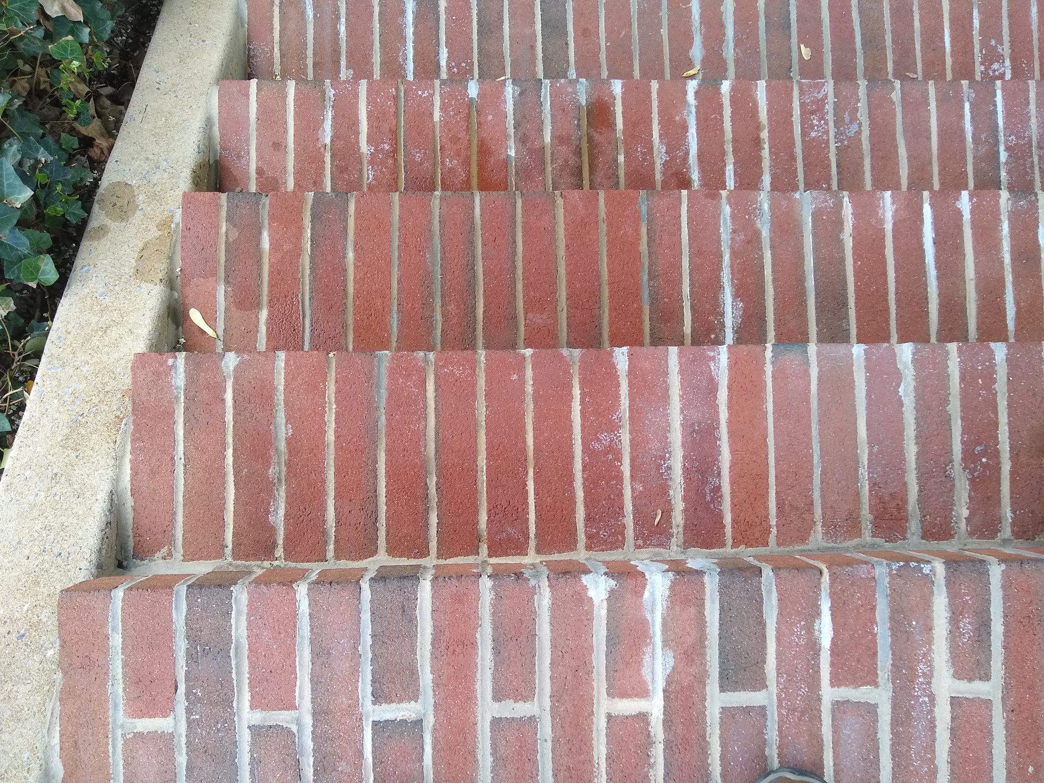

Looking for some sort of sealer or finish to apply to bricks that were used as pavers for the purpose of improving the appearance at our church. Looks like someone capped steps with regular bricks when the concrete steps deteriorated. They're laid finish side up (in the position of a wall that fell over).
The mortar occasionally breaks out and has been touched up at least twice before my current attempt leaving three or four different shades of mortar. When it's wet it looks great because the water makes it all look very similar. When it's dry it isn't pretty.

Went to paint and masonry departments at HD today and asked about their Wet Look and Color Enhancer and other sealers. The guy said these would be OK if my problem was the appearance when they became wet. They wouldn't work the other way around. Figured I'd do a little test.
Here's a picture. The row of 8 or so neraer the bottom of the picture were misted with a little Armorall. The row above them were dampened with some plain water. Appearance is almost identical. I'm wondering if applying some silicone spray may be the answer. The roughness and porosity of the brick keep them from being slippery.
