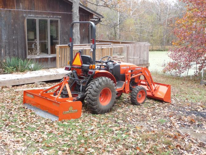

I've got the same set up as you. A B2650 with a landpride RCR1260. I did pick up the LandPride BB1260 also and it works great. The tractor has no issues pulling the 60 inch box blade. I do drop it in low up long steep hills but on flat ground it pulls a full box of gravel in M with no struggles.

I have a generic 60" straight blade that I picked up at an auction 20 years ago. No idea who made it but it weighs as much as my box blade.
In hindsight, I kinda wish I would have picked up a GS grading scraper instead of the box blade, but I'm not disappointed in the box blade either. I just use the straight blade for snow and general gravel cleanup.
