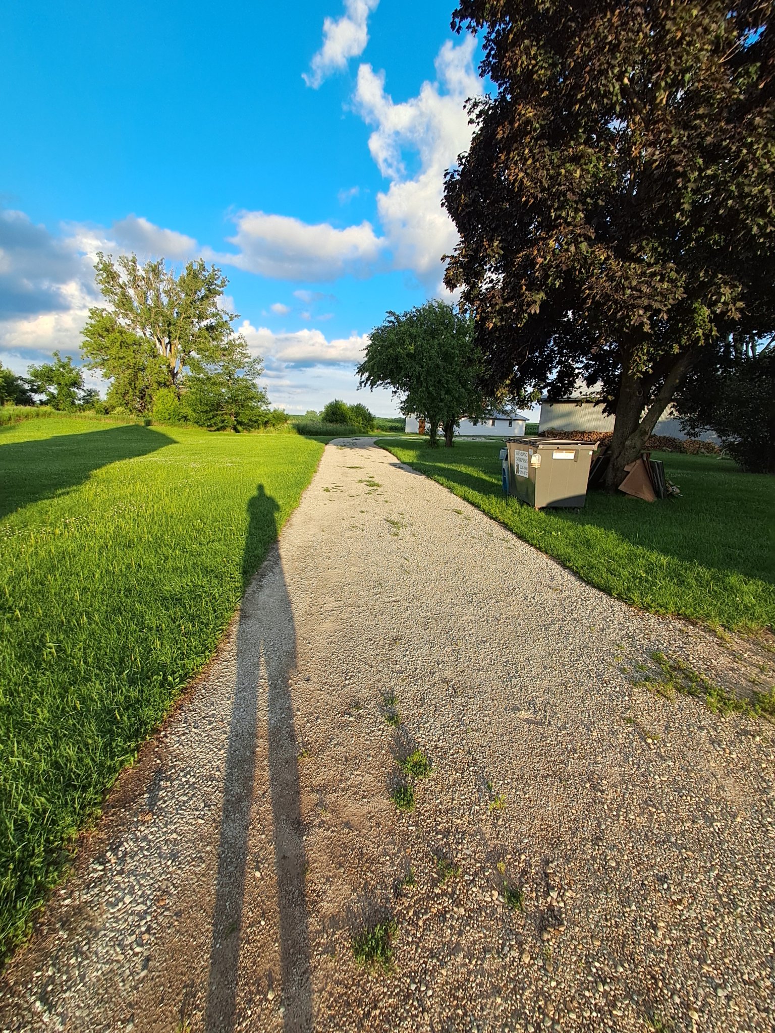

Haha yeah it's making me want everything to go with it! I already have the rear blade as well... so this is maybe a bit redundant but still different! I was all set to get the landplane and still will soon but indecisive on what size to go after as my driveways only 96 inches wide and the 72 seems too wide and 60 won't cover my tire width. I pulled the trigger on the box blade because my neighbor had came over prepped the land that I was gonna use the landplane on the night before it was set to be deliver and he made it look so darn nice the landplane would've been pointless to even go over it with... I know this was a high level of experience that he used but it showed me I can eventually get there... so I canceled the order for the time being and purchased the box blade! I just dont wanna overload my tractor since the L series has a few different engine classes and categorizing them all with the same implement rating doesn't tell me clear enough if its a good fit. I hope getting the 66" was the right move even though it was advised against from my dealer but 72" looked huge and wasnt even rated for the L series from what I saw! My neighbors is a 7ft bb and I believe it is class 2 for the tractor he had used so we wouldn't be able to share that one...

I definetly agree, and will still be purchasing one but figured since im still in the building stage of my driveways id probably be better off with the bb at this point, I've got another couple hundred feet to go and need to remove some of my lawn to continue... sadly I did about 220ft by hand removing topsoil and laying 36 tons of gravel by hand with only a shovel and a gorilla cart! That's partially my reasoning for buying this tractor! The 3/4 limestone still looks as good as the day i laid it and will eventually need to be maintained but maybe the focus should be on completing my project so figured bb first! Just wanna clarify im not as tall as i look😋
