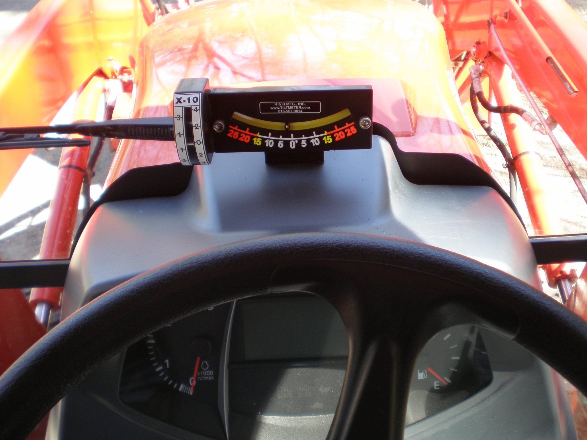

Skeets, I got my BORA spacers from UTV parts and accessories. With my L3560 cab, it is tippy on the steep hills I have. I got the 3" spacers and they were $320. with free shipping. They help a lot, but I'm STILL extremely careful on the hills and try not to get too carried away going sideways on the hills. I also added a tiltmeter to
it to help keep me informed on my angles.

I forgot to add the picture of my tiltmeter. I got it from the sales section on TBN. As far as the installation goes, I jacked up the side I was working on, loosened the bolts (almost couldn't get them off) and used a pallet jack to glide out the tires and slide them back on when the spacers were on.
