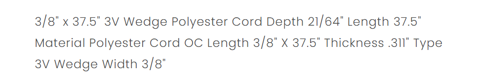

PN: 1G879-97010
You could get one at a local auto parts store.
Loosen the dynamo and replace belt, retighten dynamo.
