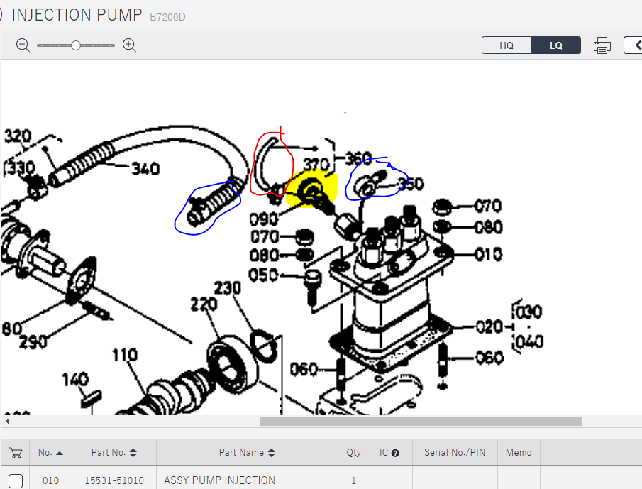

#1 Amazon / eBay Injectors are almost allway junk out of ther box.
They either leak or they don't pop at the right pressure/ time.
Send them back and get a set from Oregon Fuel injection.
The thumb screw know is the Jet Start Valve (in Yellow)
It does not shut off fuel its a air bleeder valve.
The Red circle line is a return to the tank that bleeds fuel and air out of the lines and pump.
The Blue circle fitting and line are the suppy line to the injection pump.
