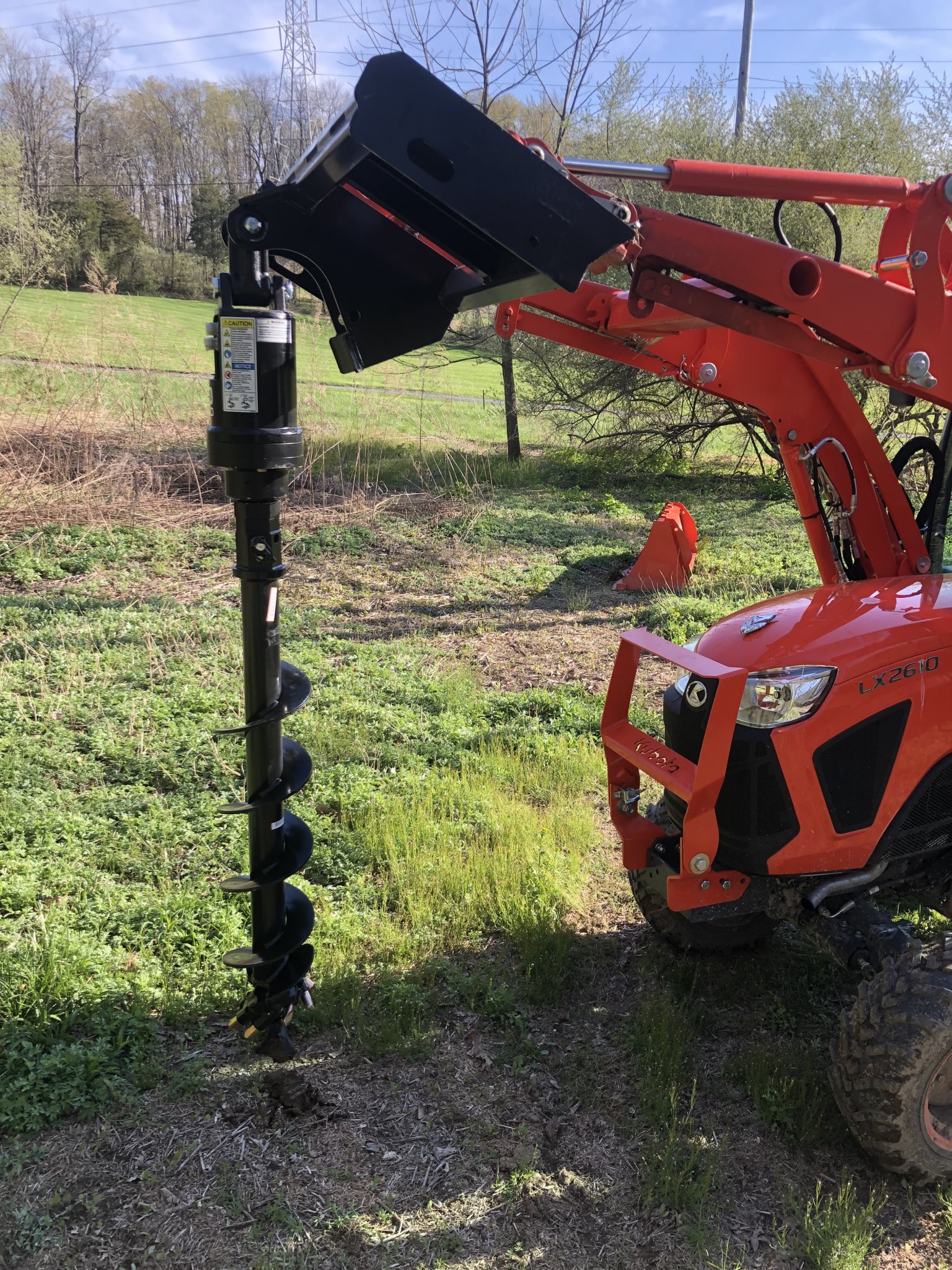

I have a Digga post hole digger that I purchased from EverythingAttachments. They have a standard bit and a rock bit. I purchased the rock bit and I’ve been happy with it so far
check them out

I haven’t clocked the rpm on my bit, but it digs holes very well. I can put down pressure on the auger if needed. But I usually put the loader in float so it digs at a constant speed.
I will try to clock it next time it’s on. I can tell you that I would buy it again without hesitation. I’m very happy with what it does and how it digs.
Next time it’s on, I will count the rpm

Thank you, NJtool. I got the gpm from my owner's manual, no actual measure. I would love to know what yours is rated at. But this is really reassuring so far. I think I could use it alone a lot better if it were out front!
By the way I am interested in a 12" and in the same rock auger you got. What is the diameter of yours? I might be better to get a 6" or 9" and drill two holes for big posts.

NJtool - not sure where in NJ you are, but I'm up north in Sussex County and my soil is all rock, so the Digga tool you showed looks like the right tool for my spoil, but I don't if the holes it digs are too big (wide) for chain link posts. This is my first time to do a fencing job, so I am still learning all the details on how to do it correctly.
check them out
View attachment 64969 View attachment 64970
That rock/earth combo auger is wicked. I have a Land Pride HD25 SSQA PHD with 9" and 12" bits but it's so rocky up here, and not fracturable rock like that Digga auger is designed for. At around $1k for those augers it's risky to invest in something that might not work for me. How is the rock in NJ?
