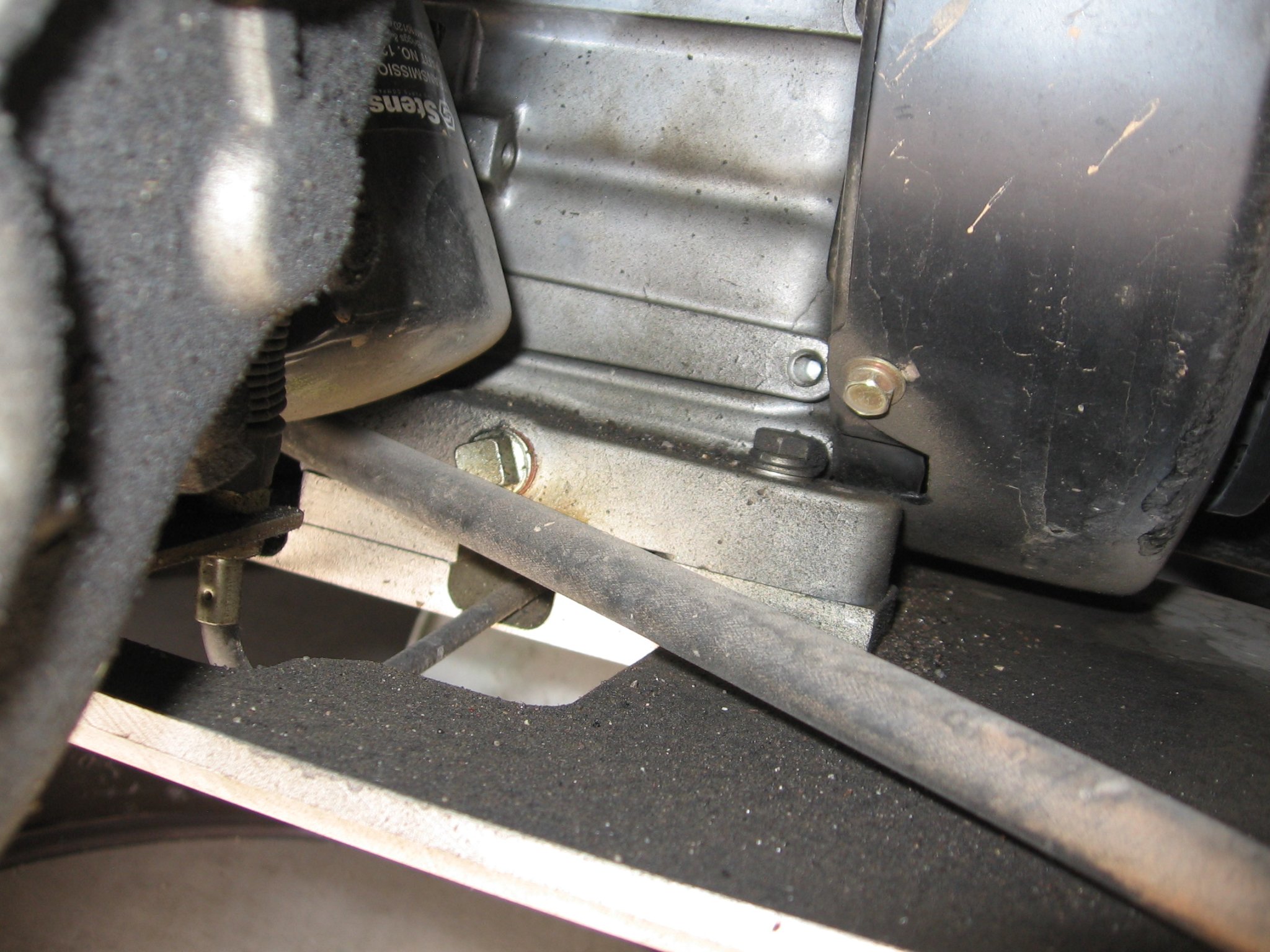

I'll have to look at my 16HP VG but seem to recall bottom of the fill tube, there's a drain port.
Old skool ,it was a pipe plug, new ones a plastic 'sleeve' you turn to drain the oil out....
7,581
2,637
My 16HP Vangaurd has the drain at the back center of the engine base.
7,581
2,637
It also has a second one in the same place except in the front.

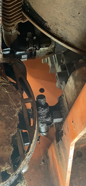

Something like this? That is on a 40horse vanguard on a scag zero turn.
If that is what you have, that is the engine drain.
