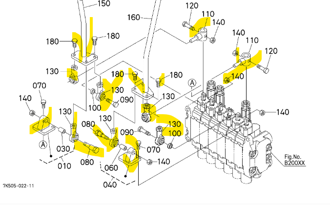

Just as the title says. It won't uncurl, open, dump whatever you choose to call it. The lever moves to curl but will after a bit of fiddling with the lever it will open slowly. The lever doesn't hardly move when you push to the right. Any thoughts?

Sounds like you need to look closely at the linkage for the operation to see if the spool valve is actually getting moved.

It isn't moving much. I don't have a lot of experience with hydraulics but understand the basics I guess. Can the spool valve be taken apart? I watched the video of the guy adding a thumb and know they are stacked.

It isn't the valve. It is the external linkage for the lever.

Remove the access cover and while moving the right control stick, look for loose bolts/slop in the Heim joint connections. Pretty common.
Don't be afraid to use BLUE locktite on the bolts
