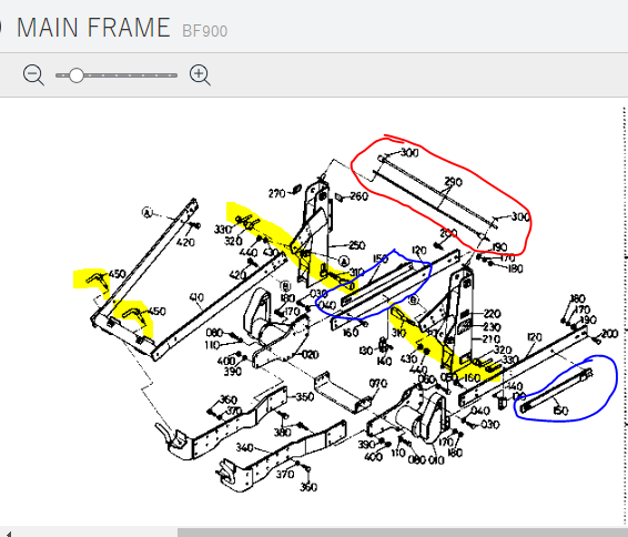

Remove 2 wedge bolts in the rear.
Remove 2 front t bolts.
Remove two front stands (red) install in sides of bucket, in pockets.
Remove two rear stands (blue) install those on bottom of rear towers when removed.
Curl bucket to remove loader.
Back up, disconnect quick connects to loader valve, and couple Power and Power Beyond back to each other, nothing goes on the front quick disconnect (tank line).
