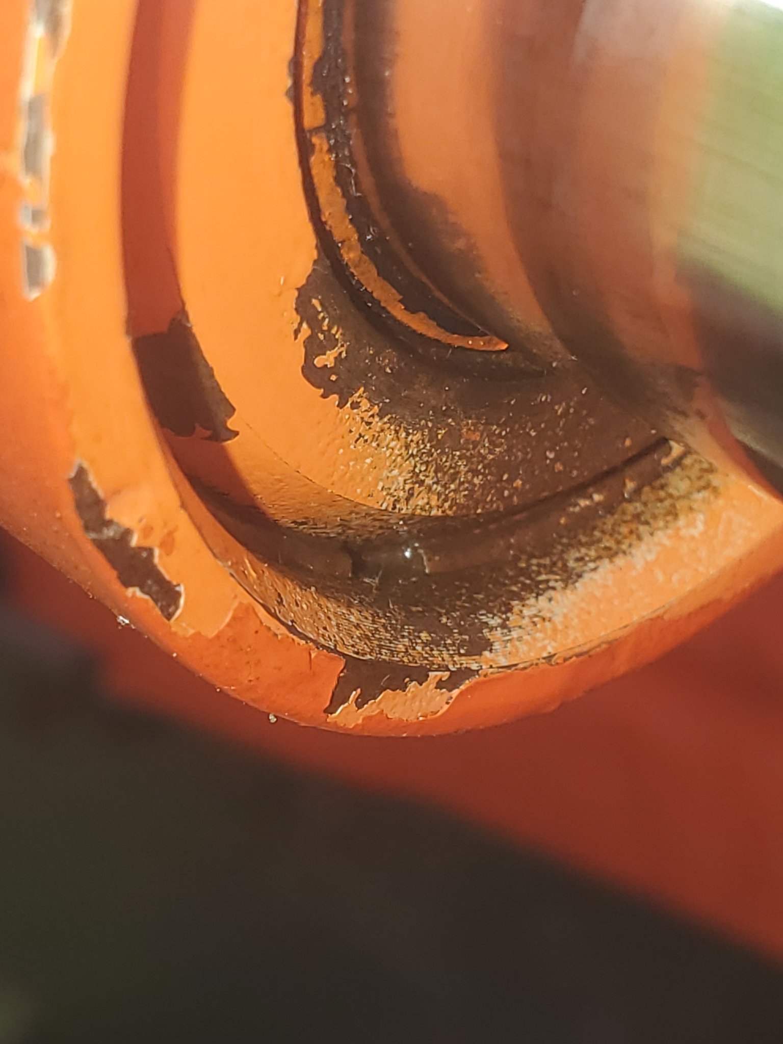

I know this is a dead thread, but there isn't much out there on this loader and as a tractor owner/new member I didn't want to start a new thread right away. I just purchased the same setup and have some weeping seals. I'm having trouble seeing how these cylinders disassemble, after watching many youtube videos with spanner wrenches to remove the "glands" there doesn't seem to be anything like that on the BF500 cylinders.

Clean the grease/dirt off the end and see if you find the eyes of a snap ring. If so, compress the two eyes, remove the ring and pull the ram out. Leave one end mounted until you have it apart and it will be easier to handle.
If no snap ring take another picture showing what IS there, and maybe the backside of the cyl (towards the engine).

Thanks for jumping in D2Cat, After cleaning it looks like a snap ring of sorts but not flat and no tabs with holes for snap ring pliers, more like wire with a split in it, maybe meant to get behind it with a pick and work it around? It's also possible I'm being overly picky about it and shouldn't worry until it's streaming out.

It looks like the style where you need to remove/open the opening to the cylinder and then you take a brass punch and tap the end of that you see inwards. That will release the ring that is setting in a slot. Then pull the entire ram out.

That makes sense, once the lines are off it'll let the end cap relax pressure on that cir-clip snap ring. I really appreciate the help RCW and D2Cat.

My BF350 has the same type of gland. The above is correct, you have to push the gland inwards, remove the cir-clip and then pull the rod out. Mine took a lot of force to get the glands to move inward; when I used a punch I broke/ chipped the gland where the wiper seal goes. I modified a thick wall brass pipe to have move contact on the gland when hitting it. I was hitting it hard with a dead blow sledge hammer to get them to slowly move.
