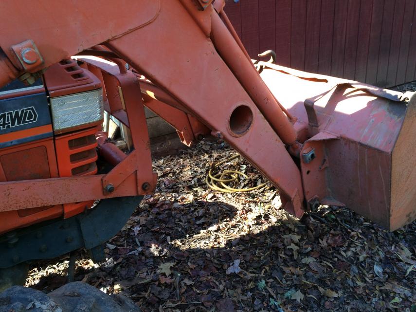

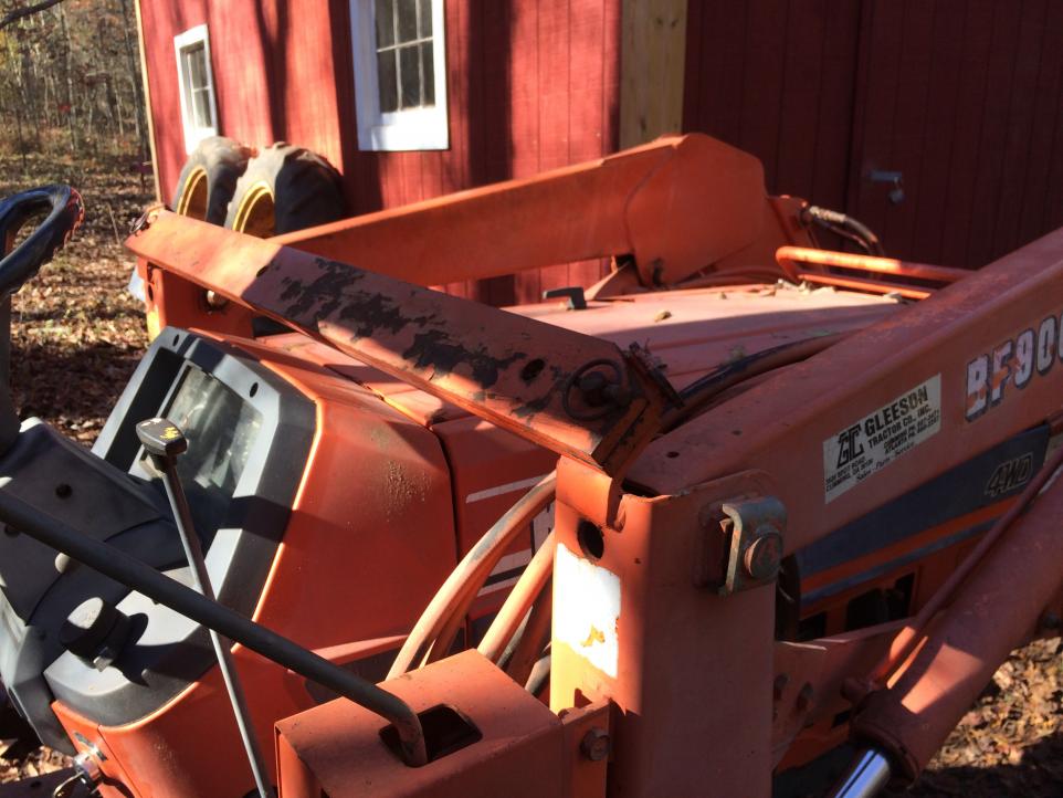

Hey everybody I am a new/used Kubota L 3750 owner and although this is my first post I have spent a many a hour over the last month searching through the forum here gaining knowledge about my new toy.
My problem is I have no idea how to take my BF 900 loader off the tractor. Well I know "how" I just don't know if I have all the parts (support legs) to do it. I've worked with tractors all my life and this isn't the first front loader I've played with but dang if figuring out what I'm missing hasn't got me stumped here. I do have the WSM, Owners Manual, and Parts Manual none of which goes into detail of how to removed the loader. Nor can I see that I'm missing any of the leg supports. I'm attaching pictures. Thanks for your help!

2 of the bars are right in front of you (they are the supports that run across from tower to tower), if it needs the other 2 they will be on the inside of the loader arms.
