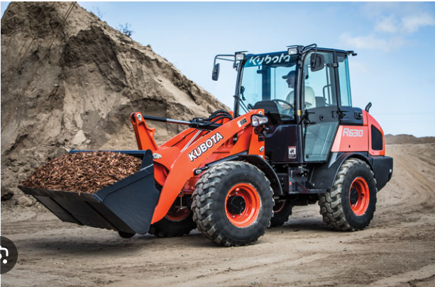

The best R530, R540, R630, R640 and a snow pusher

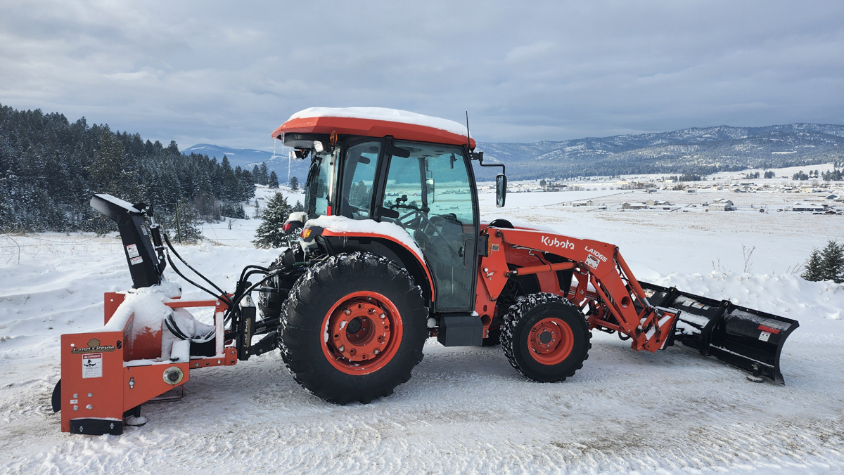

I like rear blade offset for just pushing snow off the road. I use the bucket to move piles in areas where it has to move. Do consider chains at least for the rear. Snow blowers can be pretty cool to blow the snow way off the road. I make multiple passes with some a foot or so off the ground with my rear blade to push the snow farther off the edge when required.

I had a blower and it was great for driveways but awful in parking lots. Blowing the same snow more than one time compacts it too much for the blower to handle. Many people have fastened pipe or shoes to their blades / plows to work on gravel. The only experience I have with gravel was on our driveway before it was paved. I used a rear blade turned backwards till the gravel froze solid.

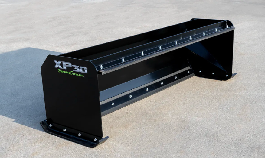

Most all of the large shopping centers around here use snow pushers but they have paved lots.
Even on gravel I'd go for a pusher and adjust the skids accordingly.

1,024
640
