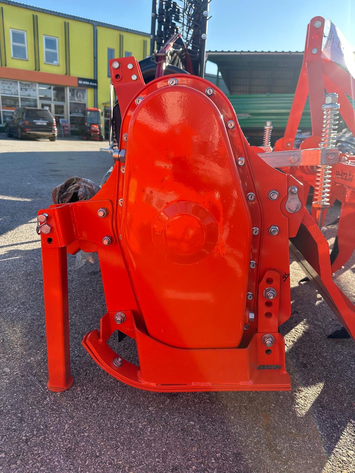

I’ve got an L2850 and an L3901, both in the 33-35hp range, class 1 hitch. I’m currently shopping 3pt rotary tillers in 5 and 6 ft width. Looking for make/model recommendations as well as pointers and what to look out for based on other orange tractor owners’ experiences. Also, is there any advantage to running a tiller with or without the fel attached?

I have a westward tiller, I keep soil tilled so I run a forward rotation on my Lx it’s a 6ft. It’s a gear drive with slip clutch. weighs 600 pounds I find I heavier the rototiller the better less bouncing. I paid $3000cnd. I looked at land pride but just couldn’t justify $5800 for the similar tiller. Whatever brand you buy make sure parts are readily available. Your loader will help with front ballast when tiller is in transport, when your tilling will help when turning in loose soil.With the weight on the front it will also help out with traction when in 4wd

I think most of the tillers on the market are pretty similar but I would recommend not buying one of the no name china brands. I would venture to guess they all have a china made gearbox. Try to find one with at least a 1 year warranty sold by a company that will stand behind it.
I bought a 6' Country Way tiller from RK a few years back. Saved a bunch of money but got what I paid for. I had to go through the whole setup process to get it safe for working even though the RK mech told me it was all serviced and ready to work. Turned out it only had a 30 day warranty and that was up by the time I figured out why the top gearbox was low on oil and the side gearbox was over filled. I guess the side seal in the top gearbox is either leaking or was left out. To use it I just drain the side box down to level and refill the top gearbox. I don't usually run it long enough for it to matter but it would be nice if I didn't have to do that. I did track down the importer that RK bought it through and they sent me the seal and gaskets. I just haven't taken the time to tear into it.

I have a Land Pride that I have only used a couple of times, but I was very happy with it's performance.
I ran mine with the FEL attached because I had plenty of room to turn around. Other than that I can't see the FEL being a big deal.
The one thing I do regret, is getting the "slip clutch" version. I think I should have not been so short sighted and picked a "shear bolt" design.
Its kind of a PITA to adjust/maintain the slip clutch and just one more "maintenance item" to deal with.
Having a pocket full of shear pins and replacing when needed seems better/easier to me now that I have to maintain the "clutch".
Also I went with a "forward" rotating model because I have tons of rocks to deal with.
I am glad I did that though, sometimes that thing jumps like crazy, but I think its better to jump around than to 'dig in".....
