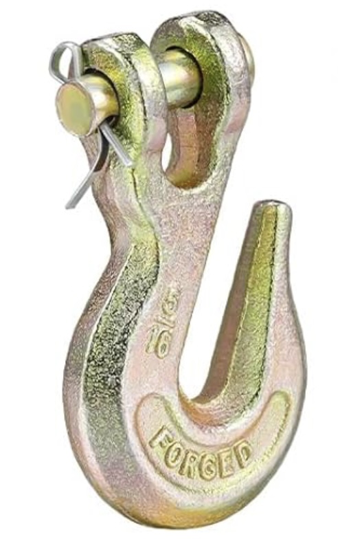

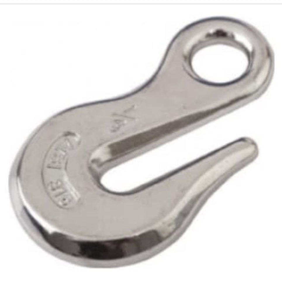

For taking length (slack) out of the chain I use two grab hooks that are joined together.
one like this
and one like this
put the pin through the hole of the first hook and use the two hooks to grab links of the chain.

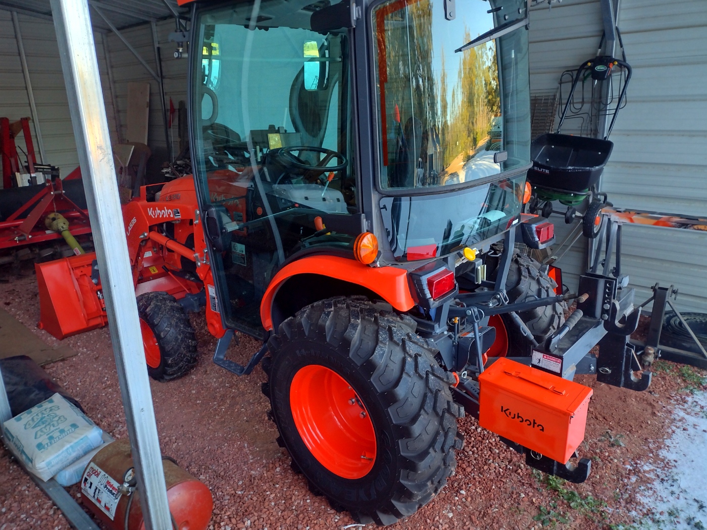

I like to use straps unless chains are clearly a better option. I have a pair of 4', 6', and a 9' that I use logging so they are on hand. They work good with a tooth bar or grapple. Happened to need a battery charge out on the landing today so took a picture.
While talking straps - if you ever need to connect two together then put a dowel in the joint so they come apart easy.
