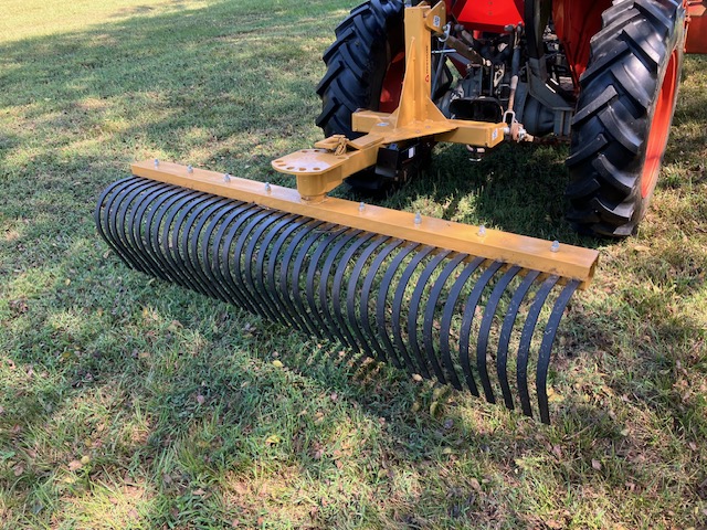

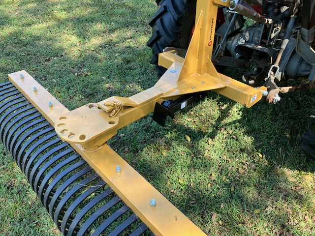

Plain Old 'Countyline' rake from Tractor Supply has worked fine for me.
If you need to actually 'move' gravel some distance it will do that too, depending on how you set the angle (with your top link). I drag driveway gravel all the time with mine.

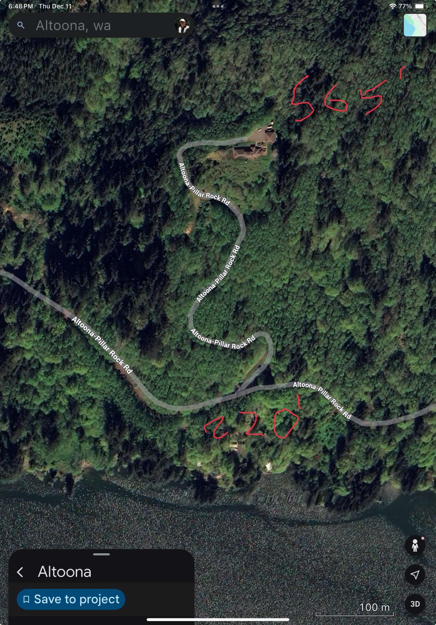

Attached is a screenshot from Google Earth of my driveway.
There is a 345’ elevation difference between the county road and the house. Some of the drag tools look cool but there is no place to turn around at the county road. I am 84 years old. I need the 3 point hitch to load and remove implements and to turn around.

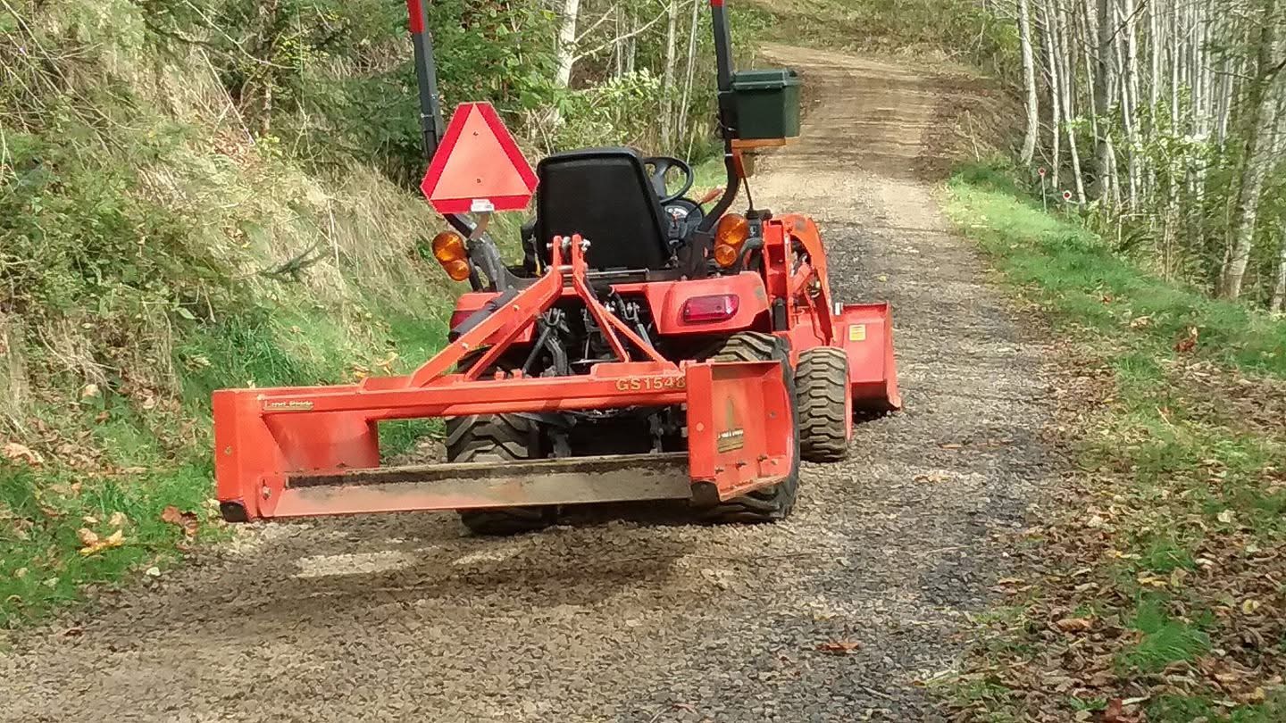

I showed a picture of my tractor and grading scraper about 1/2 way up the driveway where the grade is only 10%.
The grading scraper is made to pull gravel from the edge to the center. Starting from the house downhill it’s pretty smooth.At the bottom one starts up pulling gravel and this takes a lot more skill balancing the depth of cut with limited traction of the BX24. Over a period of time with repeated gradings it creates an odd distribution of gravel.
i need something with an adjustable angle so I can pull gravel uphill where ever I want.
I think a rake would be better than a back blade.
Thanks for all the suggestions
Peter
The Columbia River is at the bottom of the pic.
