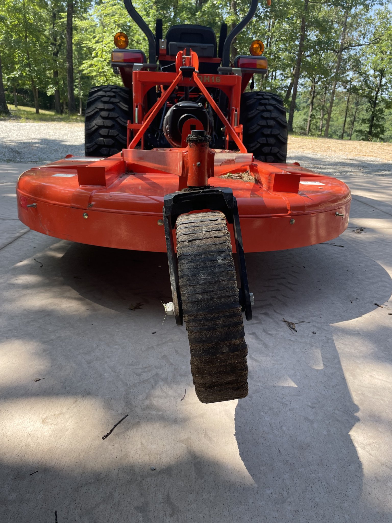

Can the wheel yoke shaft be bent straight? I backed down a steep slope while mowing and the wheel broadsided a stump that was cut slightly above ground level. Yoke shaft appears to be the only bent part and I don't see metal cracking in the weld area. Wheel still rotates freely.
I was tempted to straighten out the yoke with another broadside hit but didn't want to sever the shaft since I had more to mow.

Such damage, which is not uncommon, is nearly always caused by backing into an immovable object. Yes, it can be repaired with the proper facilities, but the easiest solution is a new yoke.

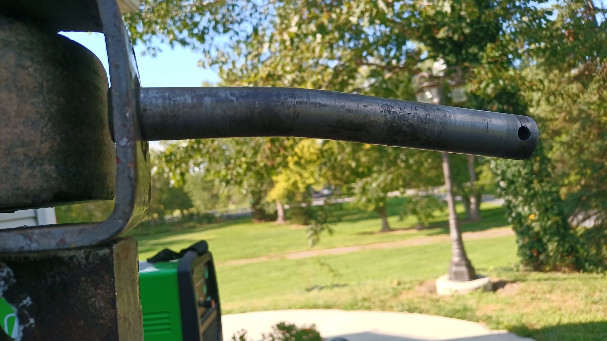

I managed to straighten mine with a big propane torch and 36" (48"?) wrench, but an oxy/acetylene torch would work much better.

remove from cutter, remove wheel, put 'yoke' part in vice with 'spacer'(fills gap where wheel was),so it's FIRMLY held.
select appropriate piping(snug and long), slide over 'pin' and gently straighten the pin. Usually have to go past '90* 'as metal will relax a bit.

A Shop Hydrualic press should be able to straighten that… if you don’t have access to one… check with a local machine shop or body shop. $20 will fix that.

Thanks for the replies. I'll drop by the dealer and get another yoke and have a machine shop look at the bent one.

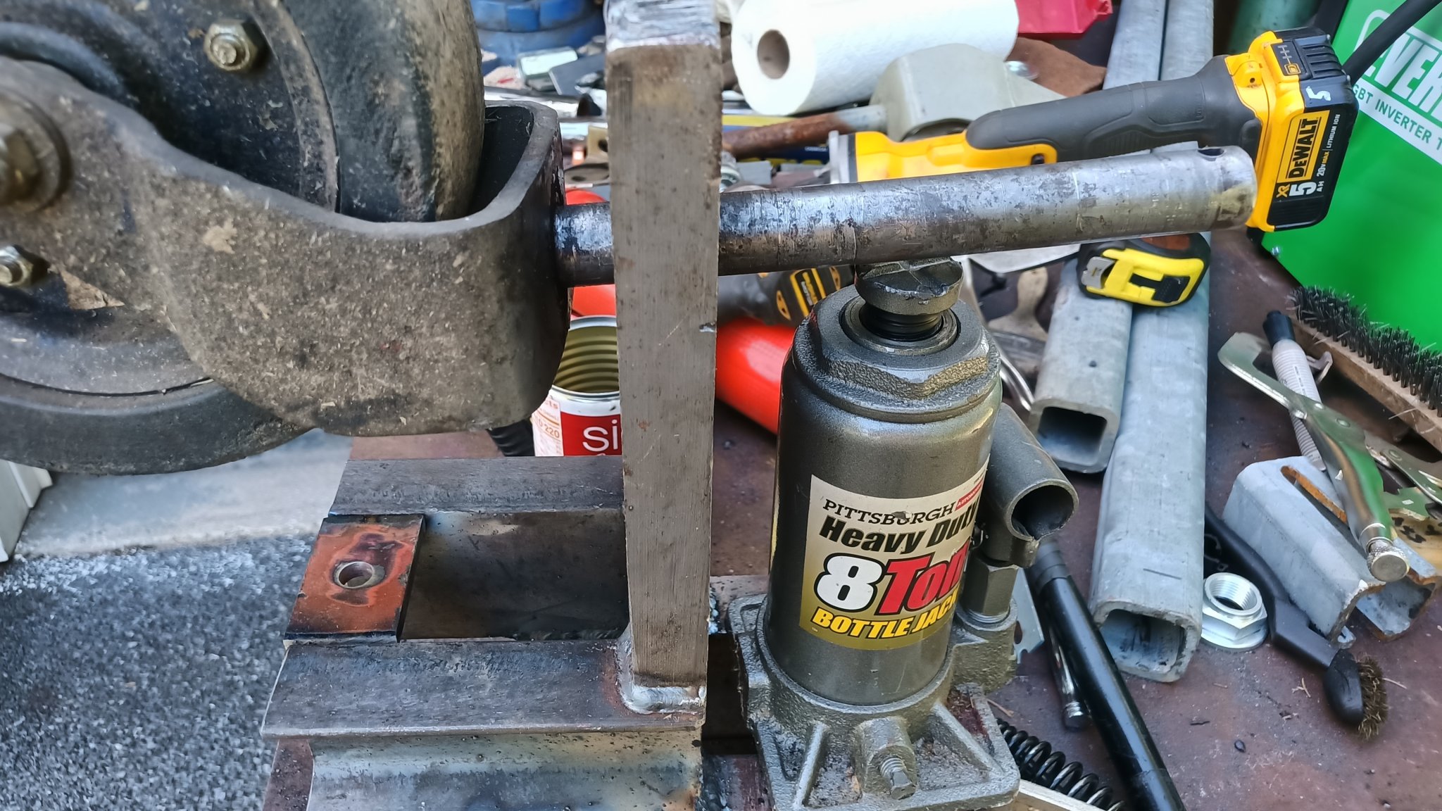

Not a bush hog, but I've bent a few on my finish mowers. It usually happened when swinging the deck into the edge of the road or a raised sidewalk. I have a simple setup made form a piece of 1" thick steel welded to a pair of 3" channels. A bottle jack easily straightens the 1" shaft.
