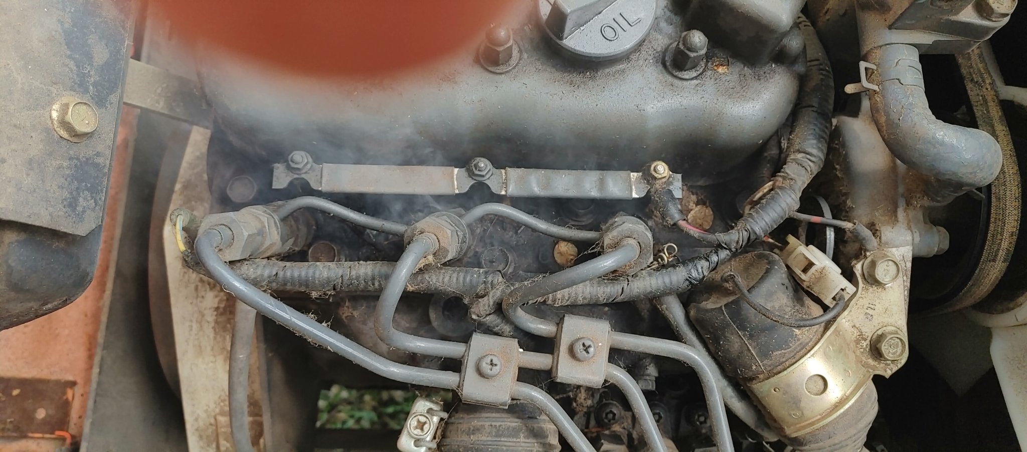

I cannot see any (major) oil in the area of the glow plugs and injectors. All the dust is still there.
Check the glow plugs, replace if required and get your engine started and see if it runs properly.

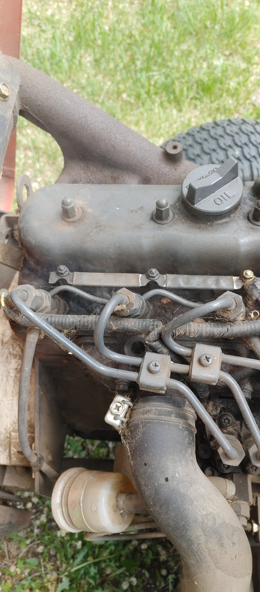

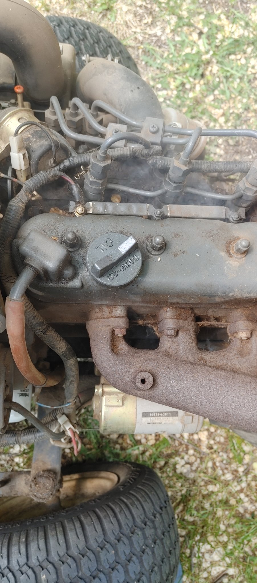

Please take some pictures of the lower sides of the engine and of the damage of the radiator and post them here.
I don’t see any oil or damage in those pictures. But you couldn’t see a cracked head in a picture, and overheat the engine is likely to cause it to crack.
Ask your friend to evaluate the situation and make suggestions on how to proceed (if they are mechanically inclined!). Does the engine rotate a full 360 degrees, by hand? Does it make strange noises when being rotated? What does the oil look like (should be black)? I might even try to start it and let it run for a few seconds but that is “risky”, but you don’t have much to lose really.

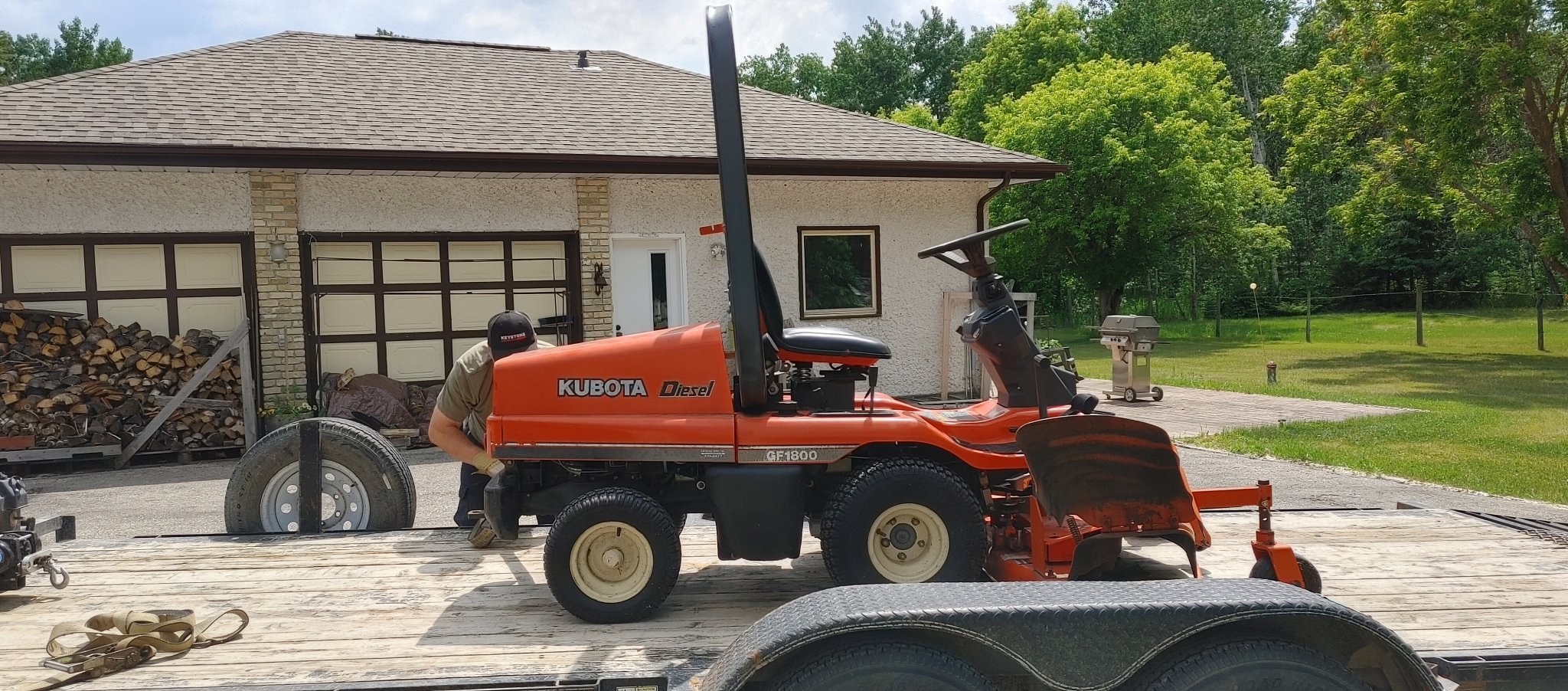

The mower is at the dealer , an hour away.
Before talking to the dealer I went to 6 different rider mower repair places around here and phoned several others, non would touch a diesel motor tractor. . didn't want to even asses it. There are 2 dealers here both an hour away, I sent it to the one we bought it from.
