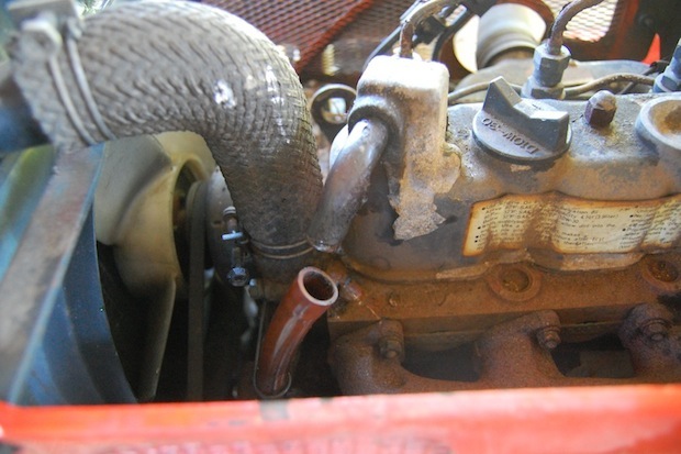

My B7100HST was overheating so I changed the oil, blew debris out from the radiator grille, and topped up the coolant. Tried to start it and it sounded like it was going to start, then lost all power and just coughed instead.

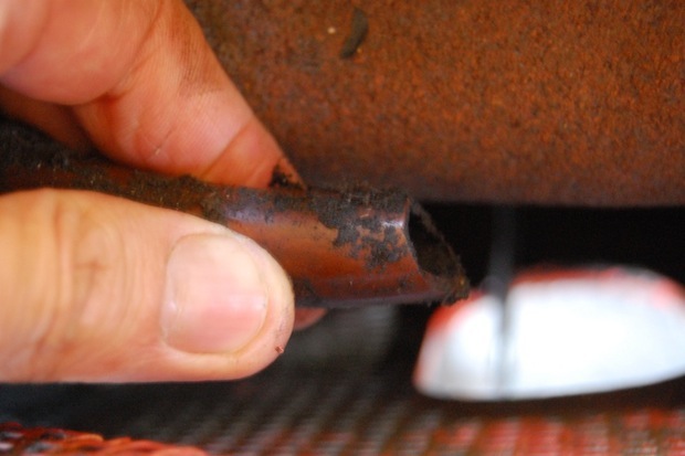

Opened the hood and a hose has come loose - both at top and bottom. Pic 1 shows the top of the hose, pic 2 shows me holding the bottom of the hose, which looks like it has torn off something.

It's just a breather hose. Replace it, it's hard and brittle. Vinyl tubing at Lowes, cost you about $2.
Has nothing to do with it starting or not.
8,168
3,535
That's the crankcase breather hose, just slips on the downward facing hose barb in your first pic, the other end is just open to atmosphere, not attached to anything. Should have nothing to do with you starting problem, maybe someone else has an idea about that.
