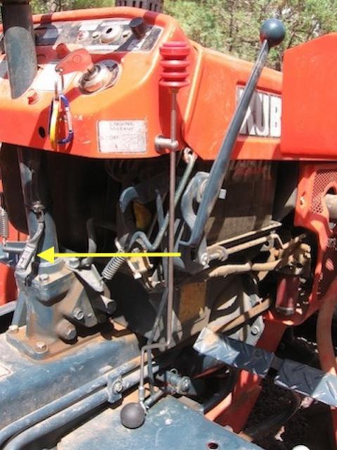

On my b7100, I used a polarized pigtail zip-tied to the steering column. (see pic, arrow)
On my Rhino, I had already wired the cig lighter socket for a constant 12V 30a, (even with key off) so it was logical to put a cig lighter plug on the battery tender.
