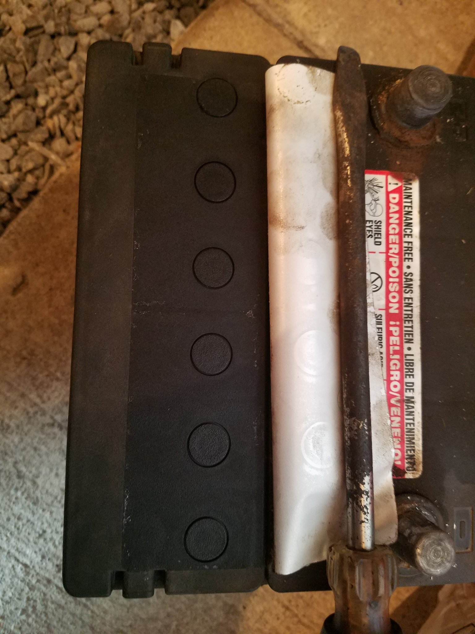

The battery in my BX2360 is dead. I would like to check the electrolyte level and recharge it before buying a new battery. My operators manual has a section on checking the level. However, the fill ports are flush with the top of the battery. Can flush top caps be removed, if so how?

Reading the white label on the first line it says maintenance free. That means they do not expect you to remove caps and service the electrolyte. If you manage to break the caps out you will be unable to easily replace them. Charge the battery and have it load tested. That's about all you can do.

MF batteries have different construction in that under designed usage they don't require water to be checked and/or added.

Time to bite the bullet and buy a new battery.
And maybe keep long metal objects away from the two terminals.....

Thanks everyone. The operators manual had me confused, it was written for both this maintenance free battery and batteries with removable caps. I will be picking up a replacement battery this AM, hopefully it will last 12 years like the OEM.
