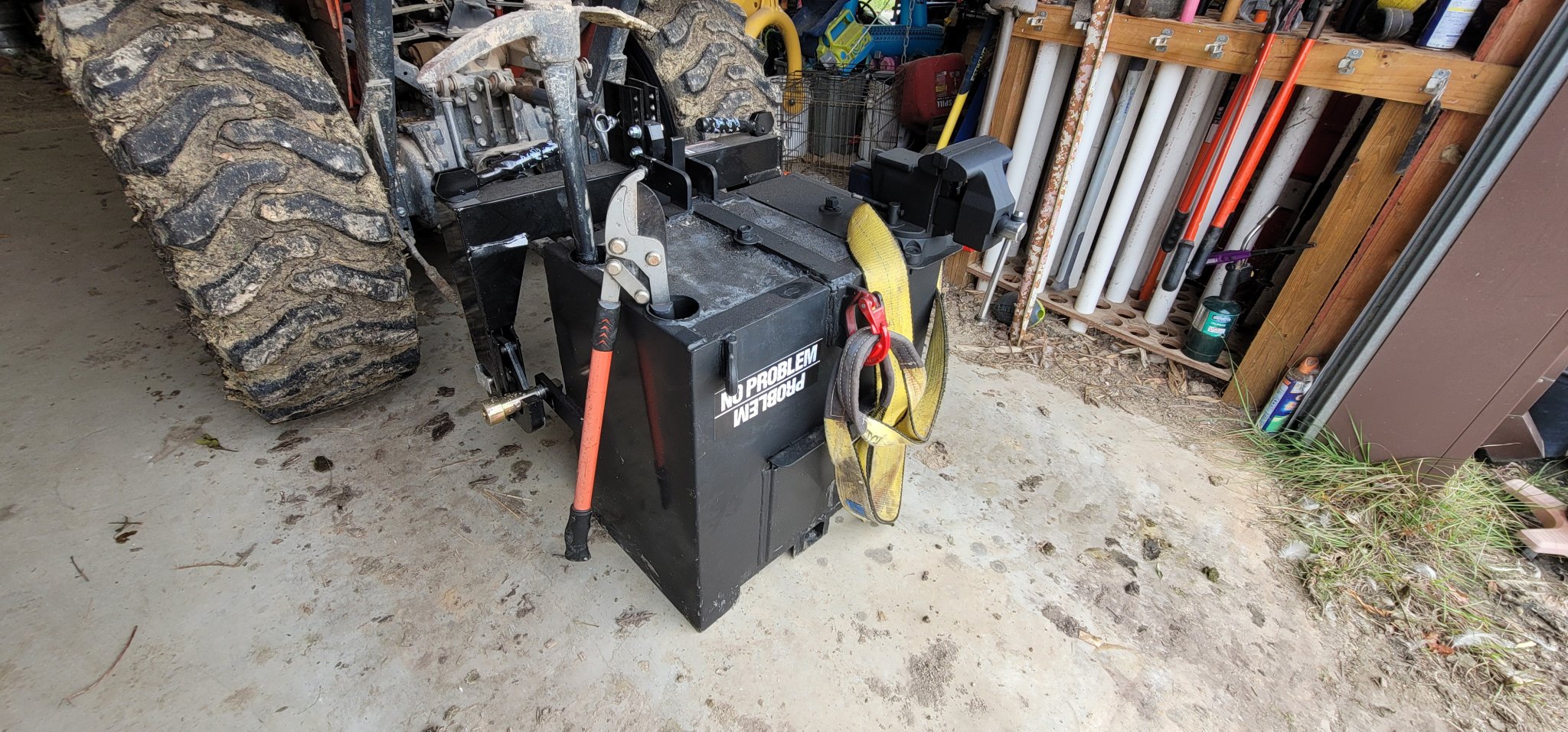

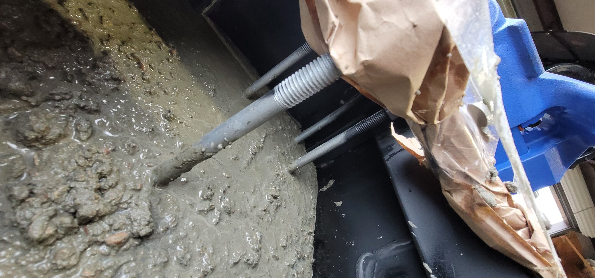

I know there are a lot of people here who dont use their tractor as a tool. This post is not for them. This has greatly increased the stability of my tractor. I lift very heavy things (over the hydros ability). This box has helped me be able to push loads of chips into a pile without tire slippage. It also helps keep the rear tires on the ground instead of driving around on front tires only using bucket like training wheels. I wielded on a vise so I can grab ahold of things and grind out in the yard instead of having metal shavings in shop.. added a brace over top and a heavy duty hook so I can yank things. (Rear tires are already water filled) 20221202_133349.jpg 20221202_133409.jpg 20221202_133359.jpg 20221125_152243.jpg 20221125_132154.jpg 20221125_140847.jpg

That's a great looking all-purpose ballast box for sure. Well done.

Nice box…I like the way you finished it. Especially Nice touches on the hooks and the vice. Think the cross piece top dead center is an excellent idea to tie the box together especially since it looks like you have a hook to pull with…well thought out.
I have modified / tuned to my needs a couple different ballast boxes and a carry all. (I plan to start a third one in the spring for the MX) I just finished (mostly)one that I started another thread on and I really was on the fence about the vice. I think I will add a receiver for that though…sort of struggling with the location to weld on though. I put another box on top that is removes me for when I do wood.
Anyway nice job. Thanks for sharing the ideas with pics.

That ballast box would've made the ballast box 'top ten' easily, but the vise!
The addition of the vise puts it at the top of the list, absolute well-thought out. (y)

central ct
