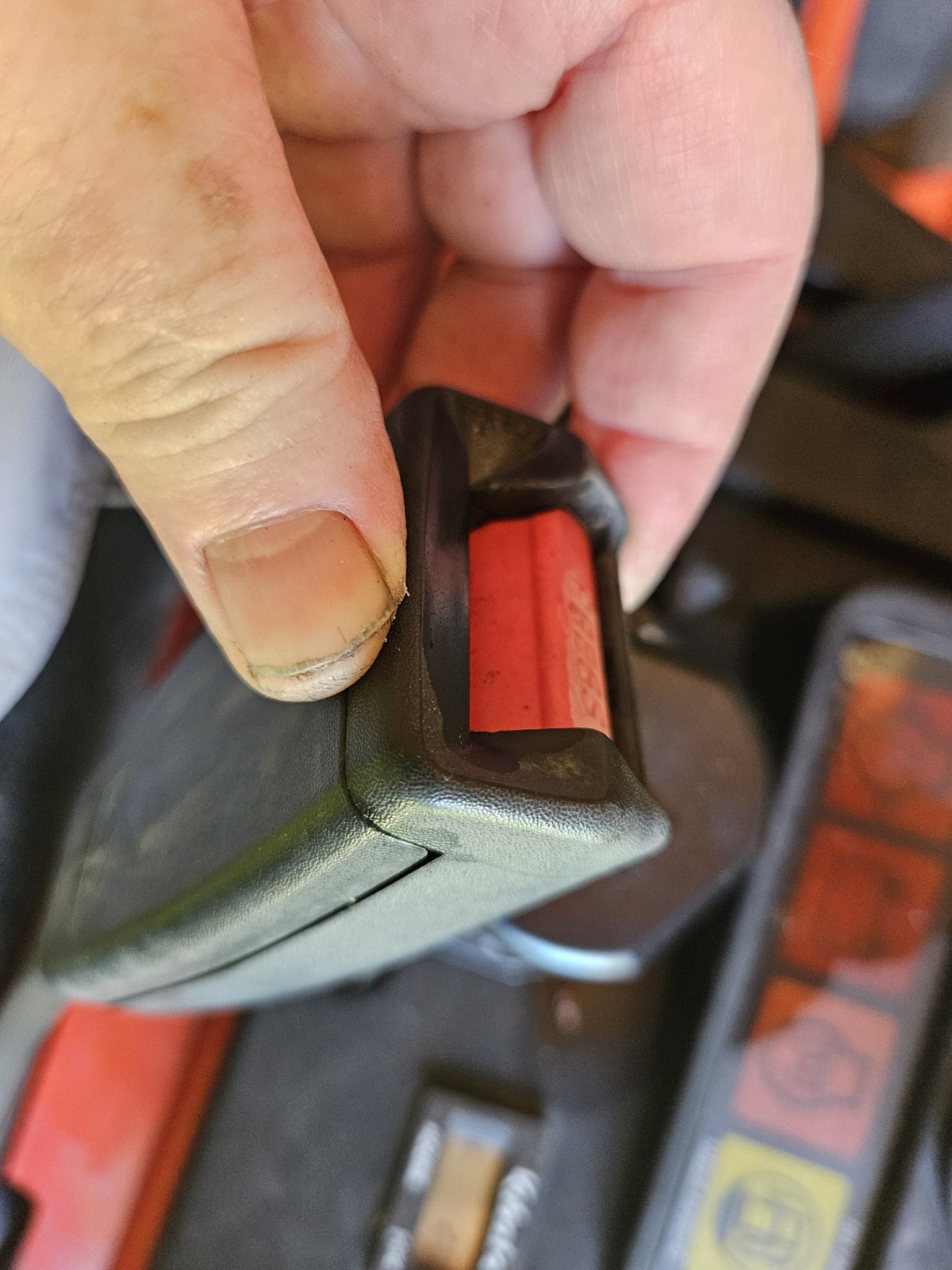

How do I open this to fix it? No screws.
#Kubota_winning

A few years ago I bought a B7500 that had the same problem. I purchased a short seat belt extender that had the same size buckle end as the tractor. I cut the plastic off the Kubota seatbelt end that would not work. I bolted the extender to the tractor seatbelt end I had just cut the plastic from. I am sorry I do not remember if there was a hole to use for the bolt or if I needed to drill it.

Mine hasn't been used in years, the release button won't depress--was this way when I bought '06 model 4 years ago I doubt previous owner ever used it.
Now that I am getting a little older and maybe a little wiser (or less stupid/more careful), and am doing a lot of work in the woods on some fairly steep trails bush hogging, moving down trees, I realized I need to fix it and USE IT.
My question is: will PB Blaster sprayed into the latch damage the plastic parts? That was my thought as the easiest thing to try first. Of course just buying the new assembly and just bolting on would be easiest but I'm a cheap ba$tard and would rather fix something if possible.

I shot Sea Foam Deep Creep into it. Maybe something will happen.

I never had regular WD40 cause any problems with plastic. While it ain't a great penetrating oil it will make little mess and provides some lubrication.

might try 2, thin but WIDE bladed screwdrivers. on opposite sides,twist and see if it releases the 'pins' from the 'sockets'. In your picture you can almost see the pin, maybe 1/2" down from the joint I'd think maybe 4 pins,2 per side ?
one of those 'need to see it ,to fix it' problems.....

Whitetiger, I can't thank you enough for pointing that out. I must have been crazy, thinking seat belts would be on the seat page. Now that I look back on it, I realize how ridiculous that was.
I found the seat belt, and it's about $109. Maybe I should look for the part I need instead of a whole seat belt, to save money.
HAHAHAHAHAHAHAHA. Whew. Made myself laugh.
Thanks for the suggestion about the screwdrivers, Jay. I didn't post that picture to show details about the part, except the lack of screws. You did a great job, picking out that detail.
Now that I know the belt can be bought, I can try to open it without fear that I can't replace it if I destroy it.

I tapped mine a bunch then sprayed compressed air inside and then finally sprayed PB Blaster in it and everything started to work again. Lubricant had no affect on the plastic.

I will remove it from the mower, look inside with an otoscope, try to clean it out if needed, beat on it, and blow air through it. If I have to take it apart, I will. If all this doesn't work, I'll put a big patch of Velcro on the tractor seat and buy some Velcro pants.

In case anyone cares, I got around to removing the old belt. I was able to open the latch by pulling on the plastic case until it snapped open. I think it could be pushed back together, but I have not tried.
I have not tried because the inside of this thing is mostly rust. There is no conceivable way to get it to work again. Rather than play around experimenting with aftermarket belts, I ordered a new Kubota part. I took my wife out to lunch yesterday, and they nailed us for $108, so I guess I should not be too upset about paying a lot for a safety belt.

I replaced mine with an eBay model, about $35 today. Hasn't let me down yet. Check how it attaches.
