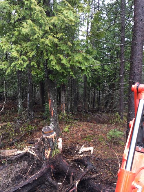

Well I braved the crappy weather and gave this thing a try.
The bad news first....The paint job aint so shiny anymore.
The good news....It didn't break in half.
Its always nice when something you welded doesn't immediatly fall apart
Worked pretty well....much better than the bucket.
First stump popped out so quick I decided to get a second one.

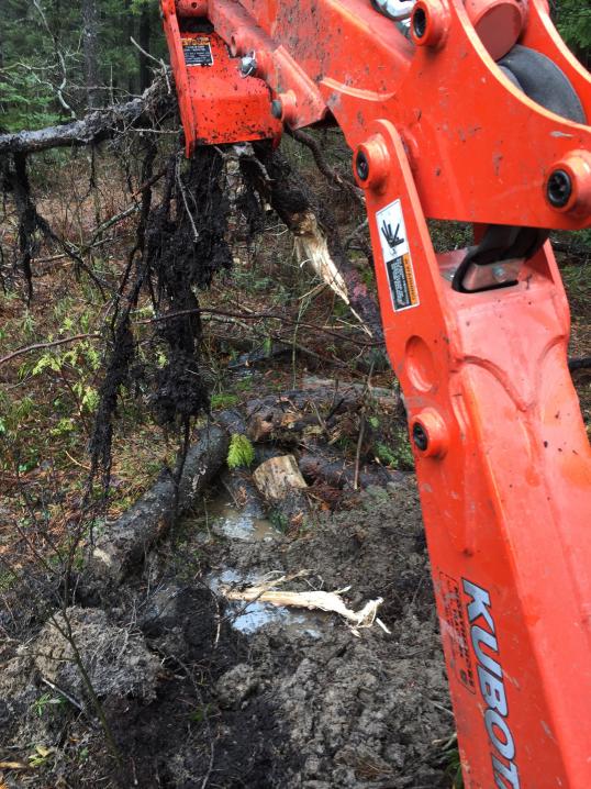

MoDMaN
May 12, 2014
Algoma Ontario, Canada
Second one put up much more of a fight.....Had some thick legs and was intertwined with two other trees and god know what else.
So 2 down 100 to go....last pic shows the forest that is coming down to make room for a second garage.
