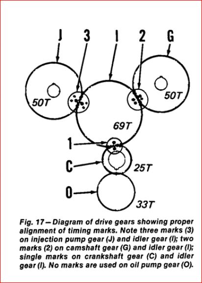

Thanks I think the head is going to the machine shop. And the front cover is coming off to check timing. Does anyone have the timing procedures?
30,537
6,594
It's fairly strait forward and simple.
But don't be fooled when you open it up and they look to be off, the marks all only align every 138 crank revolutions.
Interesting note:
Some Kubota B9200s experienced timing gear problems that were replaced by Kubota during the first ten years of service.
This is what the d750 gear timing looks like and I'm pretty sure the v1200 looks the same. ;)
