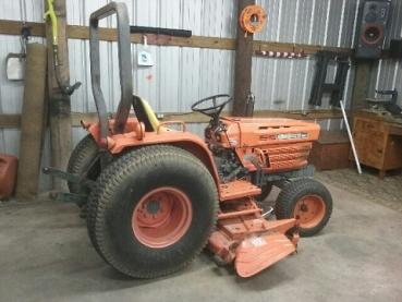

I need the belt diagram or instructions for the RC60-82H. Mine has broke and i have never replaced it before. Napa has a 5/8x111 belt even though the part is 5/8x111.25. will the 1/4 inch difference be ok?
any help would be greatly appreciated.
thanks!
