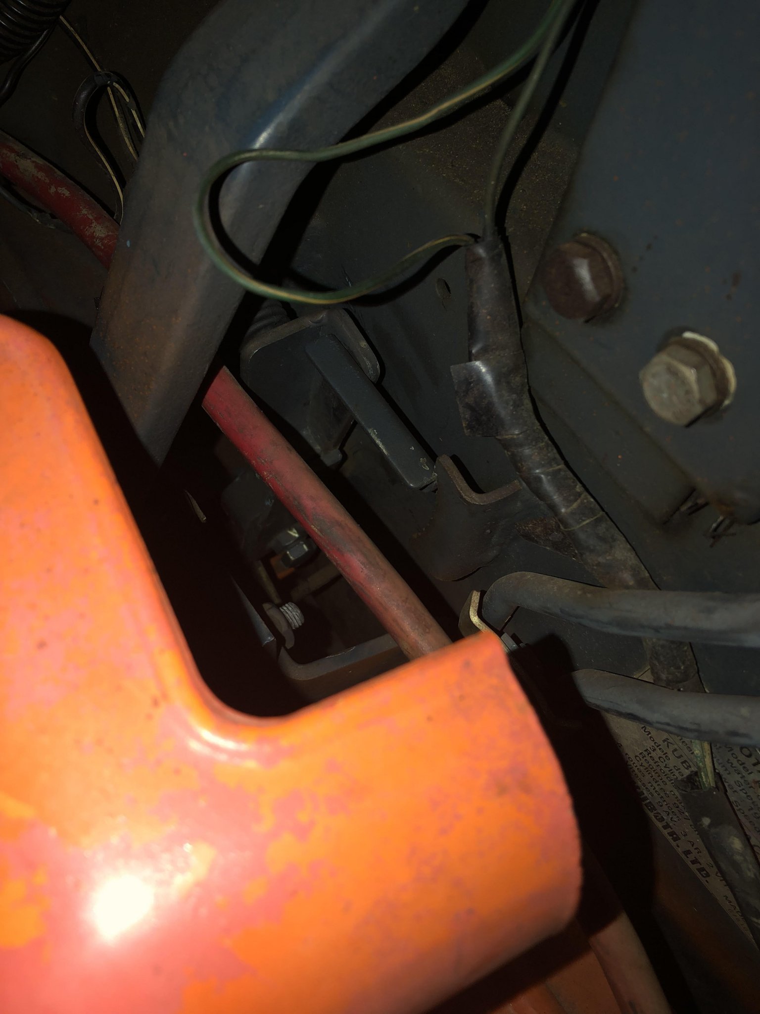

The Kubota B8200 has a dry clutch. If you store your b8200 tractor for more than a month and leave the clutch engaged (not depressed), even with the transmission in neutral it will rust your clutch and ruin it. This is not speculation, it comes straight out of the manual. There is a lever that you turn into place after depressing the clutch that will lock the clutch depressed and prevent this from happening. b8200_clutch_lock.jpg

The Kubota B8200 has a dry clutch. If you store your b8200 tractor for more than a month and leave the clutch engaged (not depressed), even with the transmission in neutral it will rust your clutch and ruin it. This is not speculation, it comes straight out of the manual. There is a lever that you turn into place after depressing the clutch that will lock the clutch depressed and prevent this from happening. View attachment 68794
The sky is not falling. My B7200 has set for months sometimes outside and in 20 years I have had not one stuck disk.
