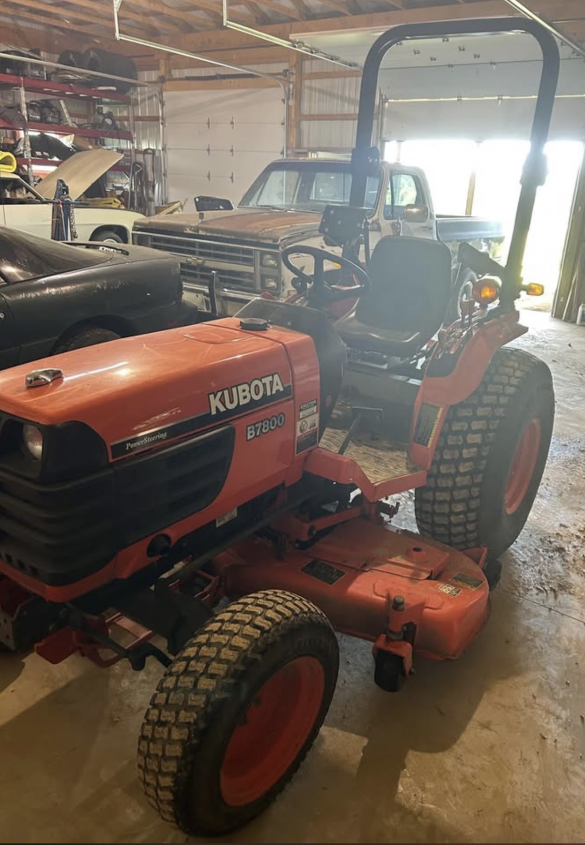

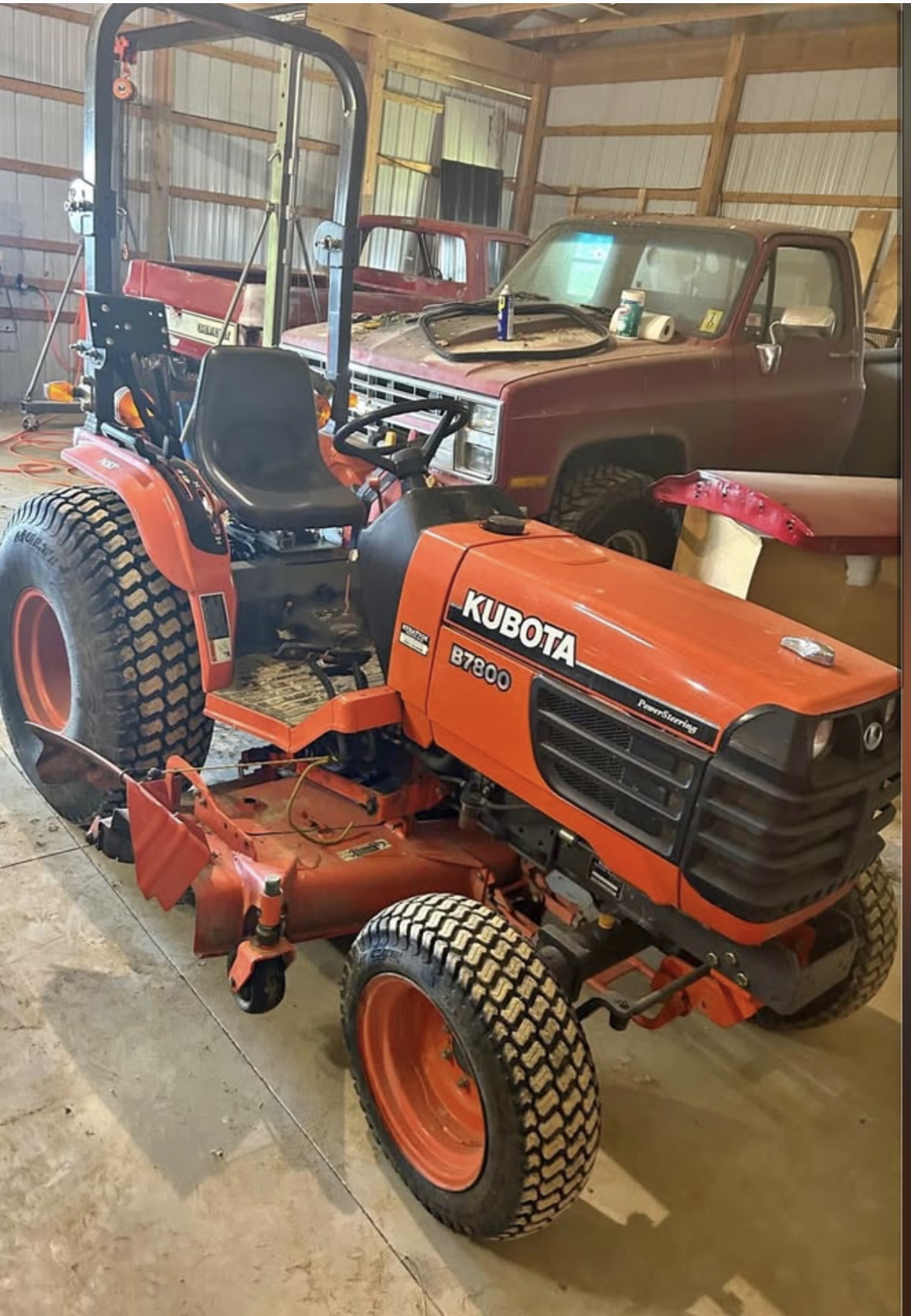

I’m primarily interested in swapping over the fixed ROPS I currently have so I can fit in my garage with the canopy.
Does anyone here know if the fixed ROPS from my B7500 would swap over to the B7800?

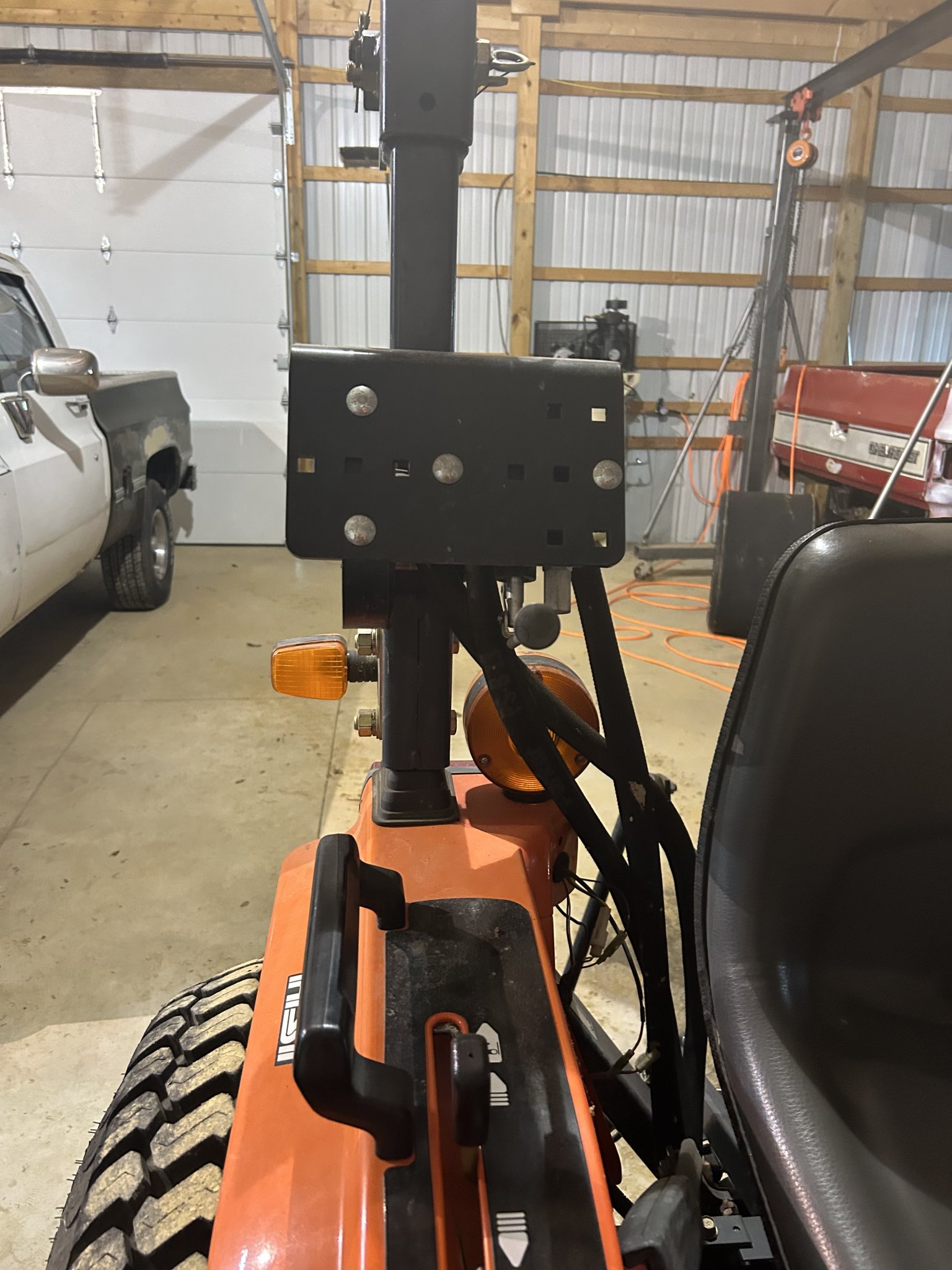

There’s some sort of rear remote on the B7800 roll bar that the seller said he never used. Does it look like a Kubota option to you guys? What could it be used for?

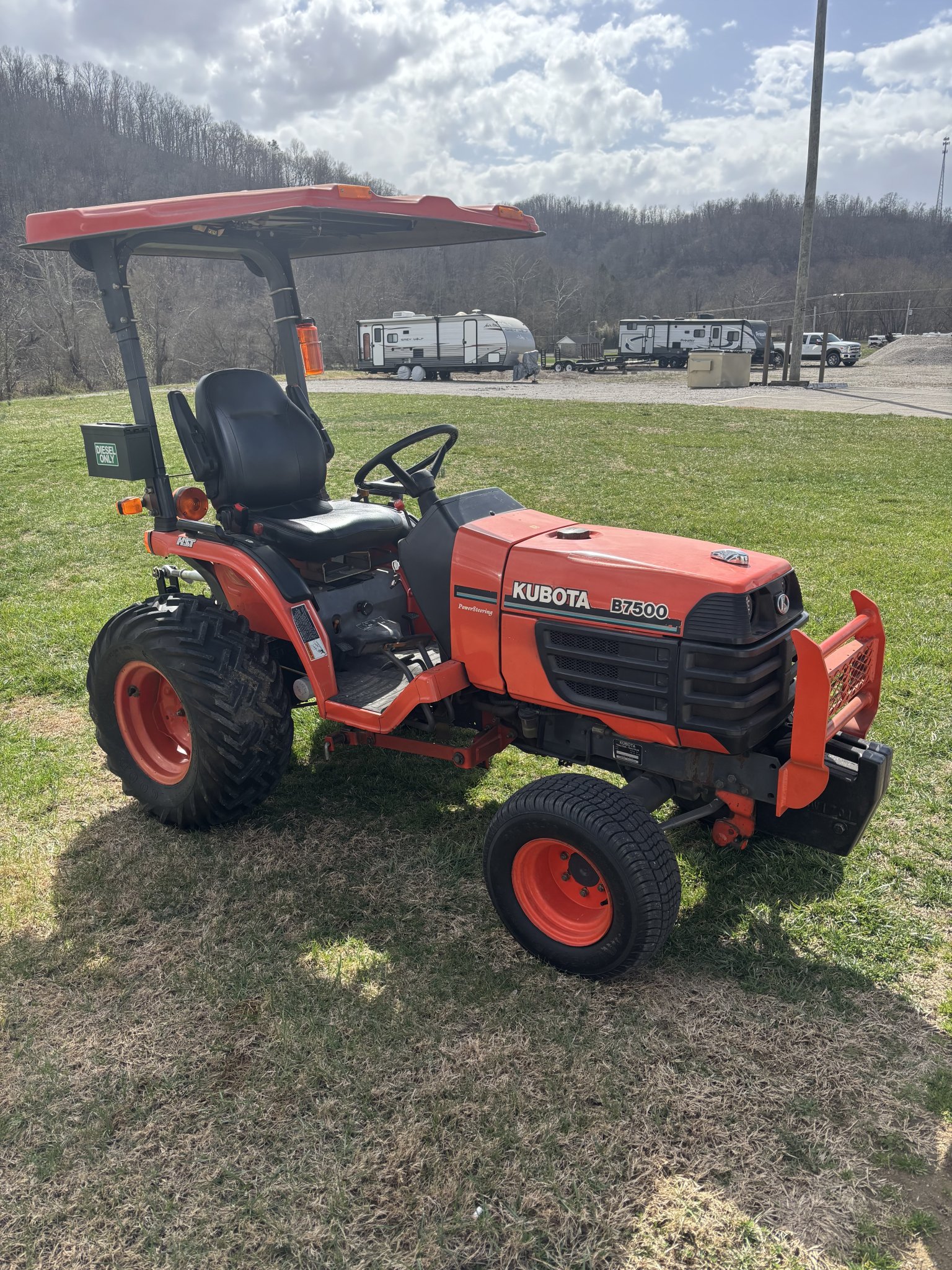

I’m throwing out a picture of my B7500 just because it’s fun to show off your toys. The attached B7800 pictures are from the potential seller.

The ROP appear to have the same lower mount so should be able to just swap them.

You sure that the ROPS are different? The B7800 has bigger tires and that may be the height difference.
