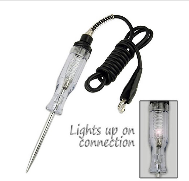

My suggestion is to use a 12 volt test light available at any auto parts place for less than $20.
Connect the alligator clip to the battery negative terminal.
Use the sharp probe to test for power going to the stop solenoid.
When you turn the key from ON to OFF there should be a few seconds of power going to the solenoid.
If this is what happens then the next suspect is the solenoid.

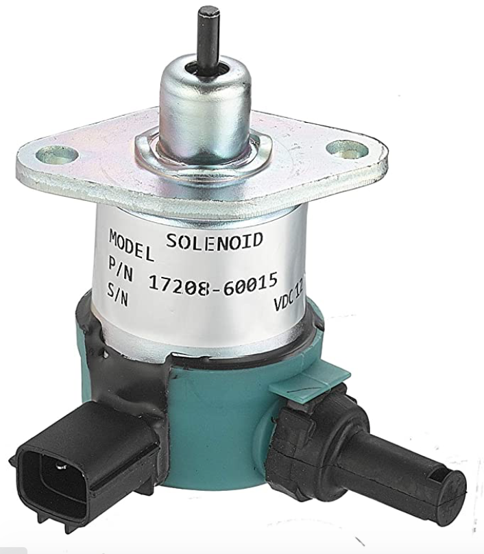

  • is the stop solenoid the same thing as the Fuel Solenoid? Do you think it is this part?

That is the engine stop solenoid or fuel solenoid.
