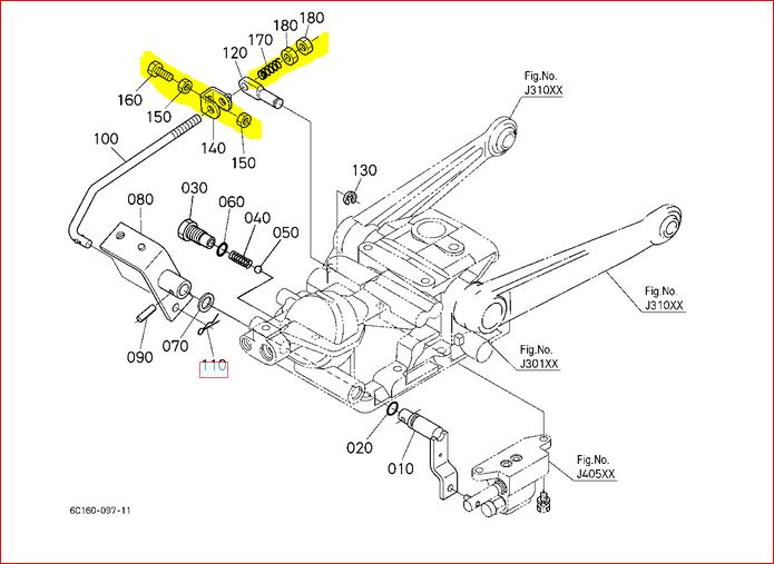

The three point control or three point feed back control needs adjusting.
The noise you are hearing is the hydraulic system going into bypass.
So yes it's a restriction in the return of the hydraulic fluid caused by the three point control being out of adjustment.
