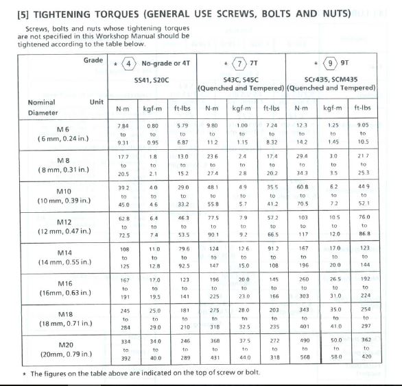

Done a lot of searching on the internet and can’t seem to find what I need.
I’m working on the hydraulics for the 3ph, And looking for torque specs on the cover bolts, and the banjo fitting. Any help appreciated. I’m guessing there aren’t too many of these models around, as I posted other questions with no responses. Thanks in advance.

You really need to get the WSM for questions like this. ;)
Get it from a dealer as there is not a free or cheap copy out there.
This is a general torque chart for bolts, Banjo bolts and any other sealing bolt do not normally get torqued, they get tightened tight enough to seal.

I know this is "snarky" but>>
U searched the internet but skipped right over the B7500 "manual" places..??
You can't get the B7500 WSM online for free or cheap.
And any of the "download sales" are sketchy at best!
